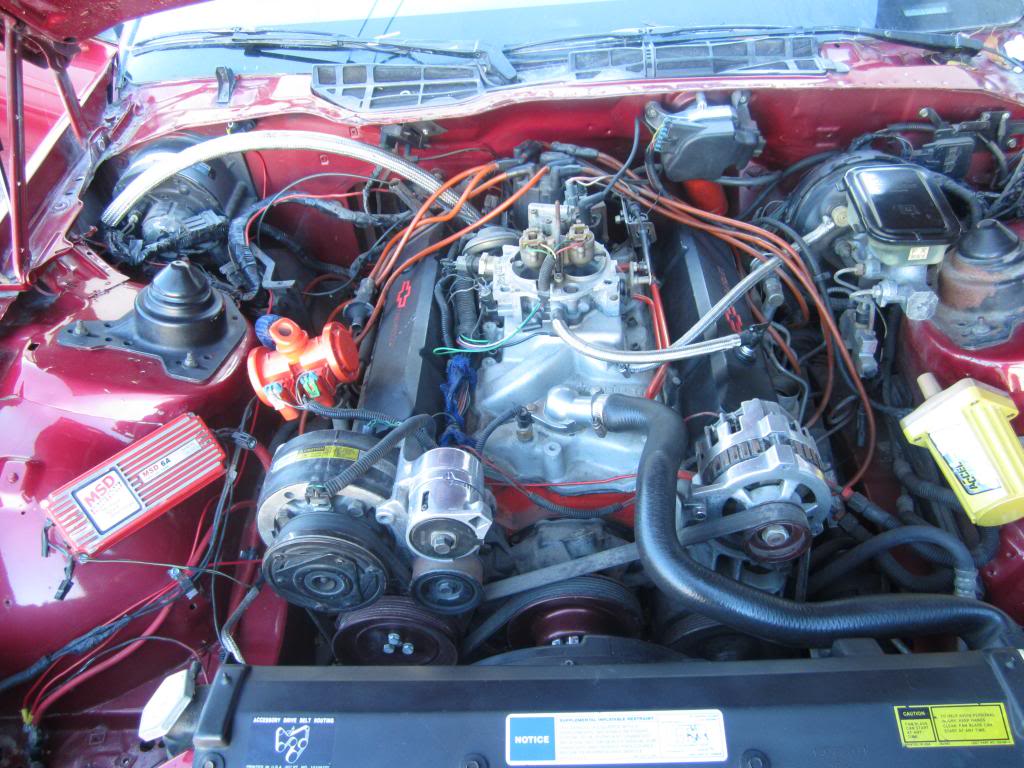

well those big wheels are off, i actually have some stock wheels but my next investment is some o.e.m z06 gunmetal wheels, do they slap right on? or would i need something else for them to adapt on...
this is my engine bay set up so far.. what do you guys think?
