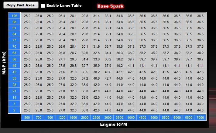

Spark Table

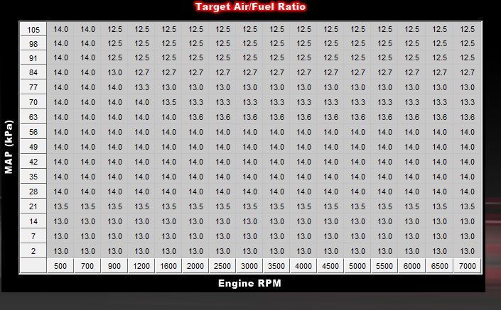

Target AFR , as far as I know even WOT is controlled by the WB02 of my Holley system

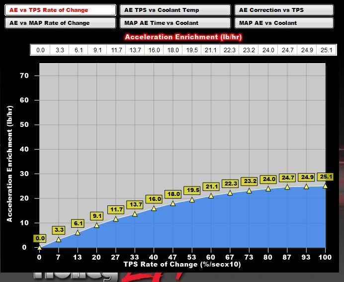

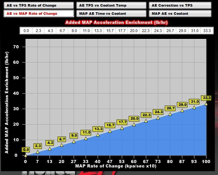

And your transient fueling tables look fat to me, that's a lot of accel enrichment in the first table. Although it'll correct, that's still having to pull out a bunch of fuel.

Imo spark is alittle low around cruise areas. Sub 2500 rpm, 60-75 ish kpa range.
Also too rich there.
Map areas 1200-2500 in kpa of 56-77 i would shoot for 14.7:1 air fuel and 35-36 deg spark. Maybe even up to 84 kpa
That should be near a 400 whp combo.
Wot lean out abit more 12.8 ish air fuel. Afr head does better slightly leaner in my experience

And a good bit of the mpg could be lost in AE transient fueling. It does seem to have alot of low tps opening fueling correction and tapers off with larger openings. Unless i am looking at it wrong
It'll correct for that though, it'll try to hit whatever air/fuel is entered in the corresponding area of the target table, unless of course it's past the limit of correction. But he didn't mention any drivability issues.
Imo there's most likely an issue of dumping fuel out the exhaust at some point. Again verify spark timing, injector timing and type of mode as well as injector %. That'll tell you where to go next.

Afr control is more of a constant parameter for a given condition
Theres no way it will react fast enough for pump shots. A quick throttle opening injection event can be over before the wideband ever sees the mixture

I also changed the target AFR to 14.7 in those cells , and the WOT cells from 12.5 to 12.8

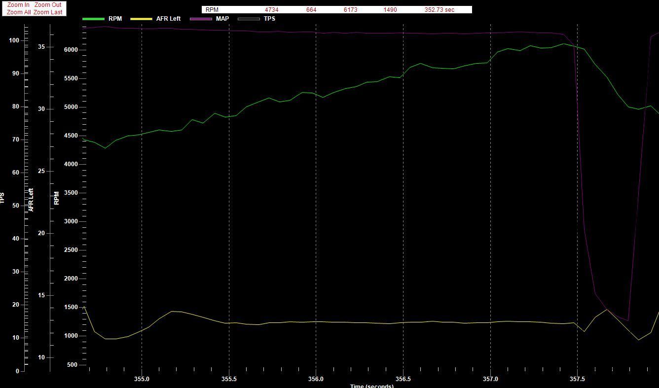

It seems that the engine likes that - I did a datalog while driving, unfortunately I left my notebook at work, so I just can tell what was going on within the log instead of uploading it.
While crusing the AFRs were around 14.3-14.9 , deceleration fuel cutoff worked aswell. Nothing special to tell - engine felt like it should feel I think. For any MPG related measurements, I will have to drive more.
At a WOT pull in 2nd gear (T56) , TPS at 100% , MAP rises to 105 , Spark Advance at 36° , AFR 12.5-13.0 , no Knock counts , nothing audible (but I am not sure if the knock sensor works properly...). In the upper rpm range (4000-6000) the MAP falls down to around 80kpa - does this seem correct?
Or could it be that this is a hint that my engine isn't getting enough air?

Bingo! Not enough air. Restriction at the intake filter and or throttle body

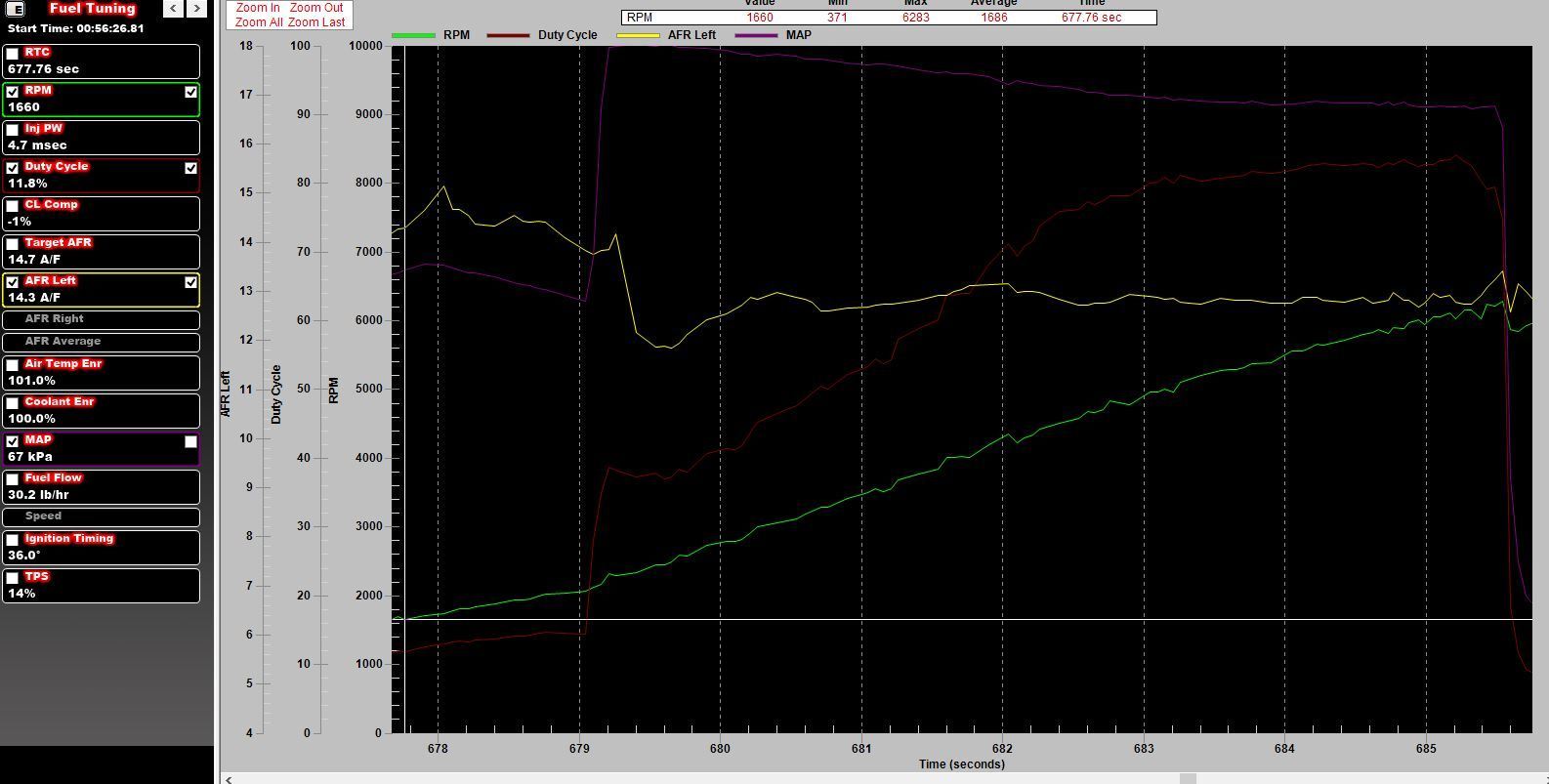

Here is the graph of the WOT pull - I was a little mistaken, the map didnt decrease down to ~80 , just 91-92 , but I think this is still a problem.
Just for clarification:
Purple : MAP
Yellow: AFR
Red: Injector Duty Cycle
Green: RPM

Yes, you still have a restriction somewhere.
And as far as correction on transient fueling, it'll depend on your O2 sample rate and processor speed as to how much enrichment "gets by" the correction. All in all it's still milliseconds. That's most likely not a significant cause for excessive fuel consumption.
However with a duty cycle of approx. 80+% you're probably about where expected on power.

Seems like its making some power. 91 kpa is still restriction as noted.
Work the air fuel curve some more to find max power on dyno. Play with timing. It may like alittle less in the peak trq area.
