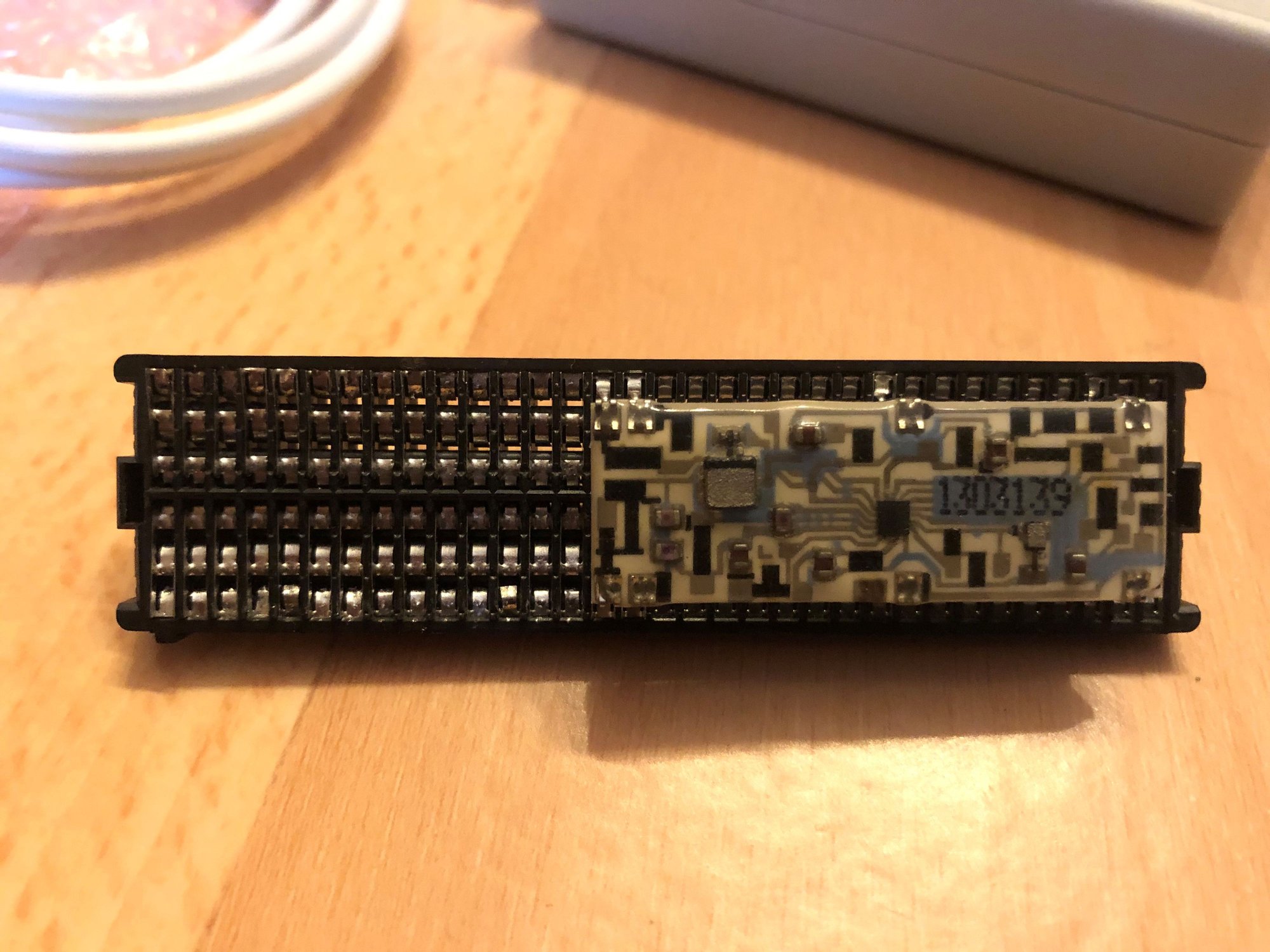

Actually I do have a memcal with an on-board knock filter board however I do not know if it is good for my application. All I know is that it has an 'LT1' inscribed on the plastic connector but I am not sure if it is correct or not. I think the knock filter needs to match the engine no? Or is it just the knock sensor itself that has to match?
Also, this memcal doesnt have the LHM chips under the knock filter board.
Would appreciate some insight on it.

The lt1 memcal doesn’t use the lhm resistors.
i don’t think adding the cylinder select jumper that that memcal will work .

What about adding the 3.8K OHM resistor to bias the 730 ECM to match the 1990 onwards knock sensor and use the knock filter board in the picture? Would you think the 'supposedly' LT1 knock filter board would work or it is the actual filter that needs to be tuned to the engine not the sensor?
Re. the LHM chips I would use the one on my current 7165 and I shouldnt need the jumper for cylinder select.

You wouldn’t need the cylinder select jumper using a v8 165 memcal.
i don’t know the answer on the 3.9k resistor. Just max out cts to enable knock.
