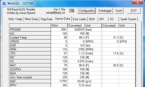

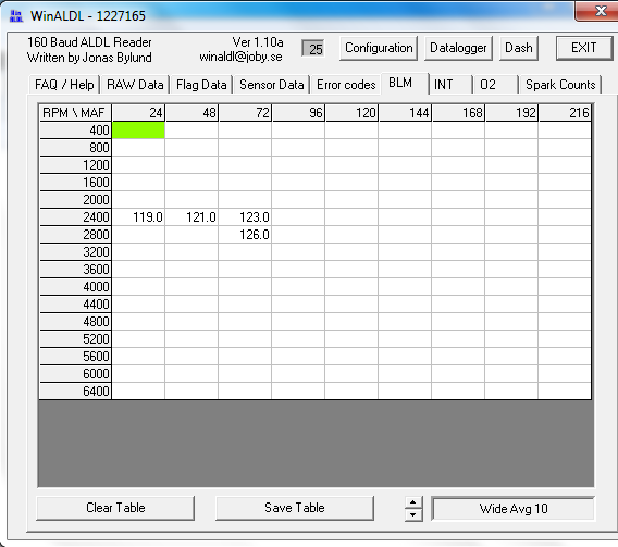

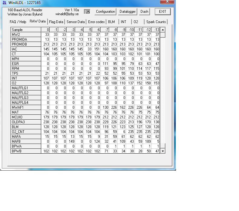

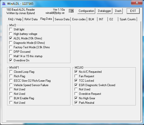

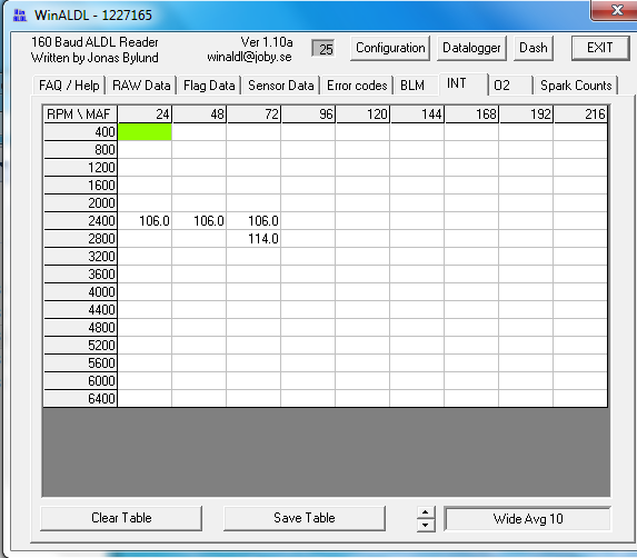

Got the datalogging and i'm still trying to figure out what it all means. If anyone has some insights from this please let me know

What’s idle gps cl ?

What is idle gps cl and how do i get that? If i need to idle the car, i can't or it stalls

The snapshots are confusing don’t really tell the story. Driving in 10k mode I’m guessing since tcc is locked. The gps fluctuation looks like possibly a vacuum leak but not comparing and live data it’s hard to say circumstances of data you posted. Cl is closed loop btw

Got it to run in CL after the engine warmed up. Good news is that there's readings from the MAF, so it looks like another problem. A vacuum leak is probably a culprit. Old lines and all
Raw data file:
