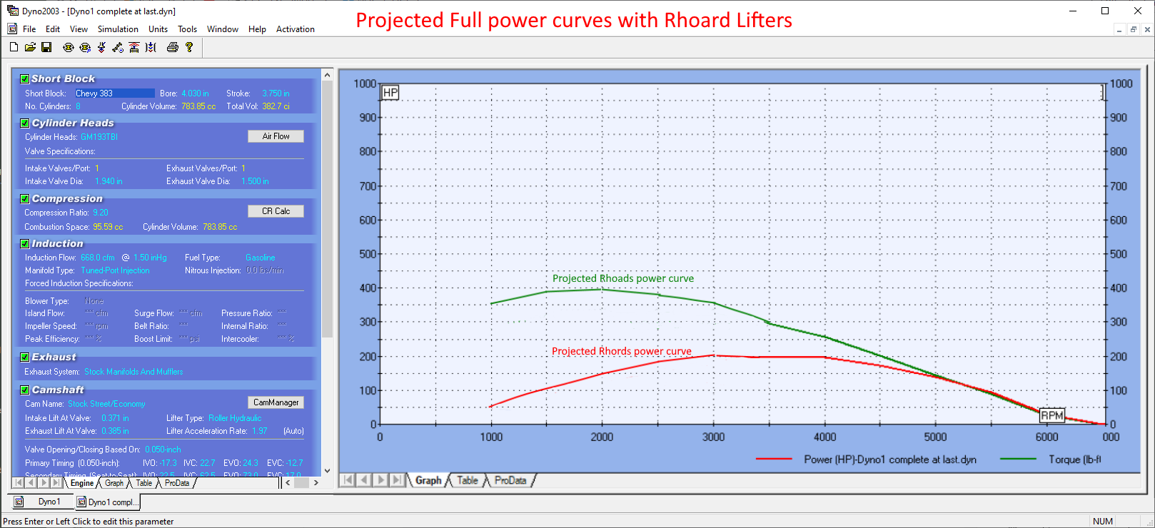

I have built my special MPG 383. 1990SBC
DYNO2003 Shows it will do everything I wanted it to do torque and HP Wise.

So here are the current details:
Vehicle: 1993 G20 van -heavy box. Built for road trips, and some towing:
Goals: Loads of low-end towing torque and the best possible MPG. There's a LOT of focus on fuel economy, as you'll see.
Engine:
1990 SBC OE Roller Block - 30 over bore 4.030
Not decked (check by machine shop to be straight) but supposed to be .010" piston-to-deck clearance
Machined 400 crank with 5.565" 400 rods
Older KB hyper D-dish pistons (M9890-30) -I couldn't find this piston but they look identical to the KB102-030, so I'm guessing -18cc dish. Set Bought 2/12/2004
As far as I know stock type rings…SEA 251K -.030 Ring Set (Premium) bought 2/12/2004
Total Seal second ring.
Top ring wide gap as per advice of KB piston tech support.
The piston top, combustion chamber, and intake and exhaust valve have all been Ceramic thermal barrier coated.
Piston skirts Teflon coated.
64cc (I think actually 65.3cc) Swirl port heads #14102193 1.94" / 1.5" valves; with good PC valve guide seals to keep oil out of the chamber.
1.5 ratio roller-tipped rockers Lift by 1.5 = .413/.428
Head Gasket: A felpro gasket that came in a rebuild kit with a 0.045" compressed thickness
Lifters: Rhodes Roller VMax lifters
Cam is from Oregon Camshaft #806 roller cam:
Adv duration: 265/270 @.006 206/213 @ 0.050": lift: 431"/428", LSA: 114, ICL: 110
9.25:1 static CR
Cam timing at .050 Intake open .7BTDC close 33ABDC 45 BBDC Exhaust open 45 BBDC and Closes at -12 ATDC this is by the spec sheet. Below these is a hand written note: -18 1/2 Degree overlap @.050. Cam lobe lift is listed as .275 intake and .285 Exhaust. Lobe center line: Intake 110 and exhaust 118.
Then there is another set of numbers lobe Diameter intake 1.542 over 1.267 and Exhaust1.529/1.244.
https://www.gofastmath.com/compressi...tio-calculator
It comes up with: STATIC Compression Ratio: 9.31:1 and DYNAMIC Compression Ratio: 8.33:1
Running Rhoads V-Max roller lifters at 10% reduction so at low rpms she will be:
185.4/191.7 Lift 371.7/385.2 lobe sep. 114 = torque peak should be right around 1800.
Intake: Will be running an 87 Corvette TPI intake and have a few different TPI MAF PCMs; the plan is to enable Lean Burn mode at highway cruise. (16.5 AF target at cruise)
Injectors: Toyota Tundra trucks from 2000-2004 came with 12 hole Denso injectors @ 250cc;
Real Cold Air Intake air box getting air from behind head lights.
Stock cast iron exhaust manifolds. Considering 1.5 Tube headers.
I plan to run lots of EGR by electronically controlled system. Both to handle the lean burn and add in MPG, and even see it engine can be run with more throttle lessing pumping losses.
And perhaps water injection...Veri-ject system or NOS injection system with under the main injectors…injectors.
Rear Gears & Transmission:
343 rear gears
Rebuilt 4L80e out of a motorhome and a US Gear Dual Range overdrive (was Doug Nash) As a second overdrive - I have calculated a 1,600-1,800 RPM highway cruise @ 75 mph with the 4L80 in OD and the US Gear in OD with the 343 rear gears and18”Wheel and tires match factory tire wheel diameter.
Van will be able to run at 1600RPMs and be doing 70/80MPH.
Many tests have shown me factory V6 and V8s can get very good MPG at 1500 to 1800 RPMs, like 27 to 32 just by driving at those RPMs, speeds are 50 to 60MPH in their top gear.
