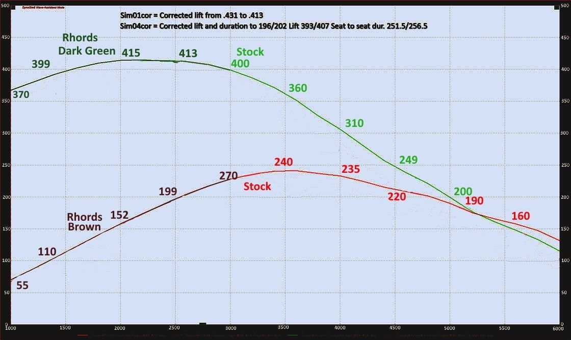

I will also state that the way I tried to model the effects od Rhoads lifters as well as tri-y headers was a failure on my part but the actual result was better than expected. Where the software model is showing peak torque at 4,500 rpm and peak hp about 5,700 rpm, with the torque converter locked up on the dyno it actually made peak torque at 3,100 rpm and peak hp at 5,600. The torque curve was almost table top flat from 2,000-5,000 rpm.
