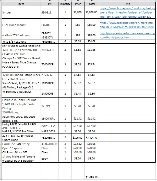

I will attach the list from my sniper build with a 5 speed
Airbags should still work
Not100% om the Tq converter you might be able to use the sniper or get a 700r4 lock up kit from painless or someone else
2 options for a distributor, either a vaccum controlled distributor or the sniper hyper spark system
Yes your speedometer will still work.
