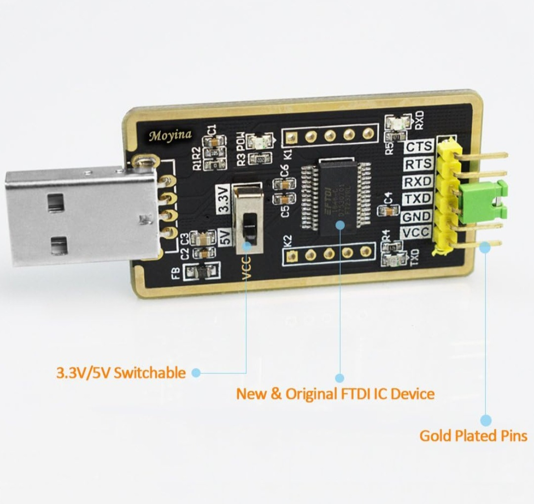

Hi I am using a USB to TTL adapter by SB UART.
I jumper the TX and RX together and connected the wire to the car ALDL diagnostic connector port M and the Ground wire to port A.
The data is weird, I either have a bad ECU or the wrong Data Definition.
The $32b ads/ adx is that a Bin file or a Data logging Definition file? I need a data logging file for a 1988 Camaro 5.7 TPI with MAF.
Thank you.

you can also use winaldl to see if data looks good. Before you connect tp or winaldl use a 10k ohm resistor across a to b at the aldl then hit connect.

Idk a whole lot with the 1227165 ecm... Your cable interface will suffice adding the 10k ohm resistor. With winaldl or TPRT sorta remember that pin E gets you 160 baud data which is super slow whereas pin M data is transferred at 8192 baud 50x faster. I mentioned this for the mere fact that your ads file ends with "160." Idk if there's a 8192 specific ads/adx but I'd try to download something that's been more developed from one of the links provided^^^in this thread rather than what can be downloaded from tprt site. The quicker baud rate is where you wanna be for datalogging but if you're just wanting to look at snapshot data the 160 baud could suffice. i.e. TPS volts, batt volts, coolant temp, cel flags, etc...
ads/adx is the datalogging file used with tp v4 and v5 respectively.
