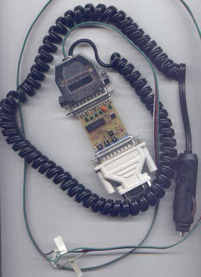

hey craig i tried that 232 link thing tonight, I built the other end of the cable, as described on the AKM web site, i think i did it right, but the AKM site said that the end going to the car needed a Female adapter, but the way i oriented it, it needed a male adapter, which way should it go? I will scan a picture in a couple minutes and post that, any and all help is apreciated, i have been at this a week already, and its starting to cost me $$$

here is the picture, i used solid strand wire from rat shack it was like $4 for 20 feet of it, and it is 4 strands wide, so i just used 3 of the 4 strands and called it good. Do you think that the wire, or the 9 to 25 pin converter is the problem?

Your cables are installed exactly backwards. See Andrew's site for details:
http://www.akmcables.com/assembly.htm
This should clarify, and serve as a good reference for others.
Like you said, to get it to fit together like you have it, you had to do things backward...

okay, i got it reversed at least now when i link to Hyperterminal it will let me type stuff, (but it doesnt echo it like it's supposed to) Anyway, when I launch your software, and set it for COM1 then go back and press 1 it says the sending data thing, then last byte from com port 0. I am beggining to think that Morley was right, and taht my data wire is broken from between the ALDL connector, and the ECM, because i cant get the Auto-X-Ray from work, to link either. I know that the cable i built is correct, because when plugged in it makes the idle jump to 1,000 RPM but when its out it idles at 500-600 RPM like normal! Please any suggestions are appreciated

take a multimeter and doa continutity test from the ALDL connector to the ecm on all the pins. ground, data. i would also unplug the ecm to ensure no false readings. iff you get more than say 0.001 ohms i think you have a problme. it should be 0. but a bit or resistance is ok. also do a wiggle test and makes sure that the pin in the ALDL connector is making good contact.
just my thoughts on the subject.

The 1000 RPM means that the 10k is in place on a 86-89. The rest of the cable could be FUBARed and it would still give you the 1000 idle.
