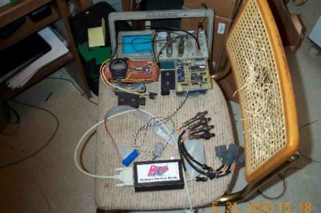

The only practical way of running two ecms with exactly the same inputs to compare the two is running them like this.
http://www.diy-efi.org/gmecm/project...cm_tbench1.jpg
Also, once you run one ecm with a known bin, you can set the other ecm in a duplicate manner, and see if in real life the cars run about the same. Given enough data points you can get real close.
That way you can steady state them and scan back and forth between the two, and see what's really going on, negating any external differences that would effect that data in actual useage.

See attached,
Items of some interest.
4 WB sensors
Lockers data logging board
Direct Scan data logging.
In car portable timer, for being able to do back to back testing. Designed and built by me for being able to accurtely do back to back testing.
2 experiment late model MAFs, underneath the incar timer, and locker board.
Hmm, looks like a complete collection of data gathering materials.
Scope is just for background.
Sorry to join the thread but I haven't seen this setup in actuality and have been looking at incorperating something like this into a front hub bearing with H_E sensor...
This looks like the setup mentioned in the tuning tips page at DIY. Any chance you have some closeups of the board, or any more application notes? The Nat S PDF didn't quite help me out on which sample circuit could be used for it. TIA, -Matt

I'm flattered that you went to all that trouble to take all those wonderful pictures to do nothing more than prove my exact point. If I wanted to sit in a dark dreary room on my chair that was falling apart and turn ***** all day, then I guess you have me LOL. And just for the record you can check my website for some of those gizmos too. And also videos etc as proof of everything I say I do also. Since you insinuated that I was lying and my testing would be falsified in some way.

Once again thanks for the nice pictorials you provided. :cheeers:

They're all tools, the more tools you use the better the results. Track, WB, ECM bench, dyno, anything you can think of.
Like I menioned earlier, just swapping ecms and running with static injectors is pointless. First element is finding out where you are, and that means having the tools to know where your at.
