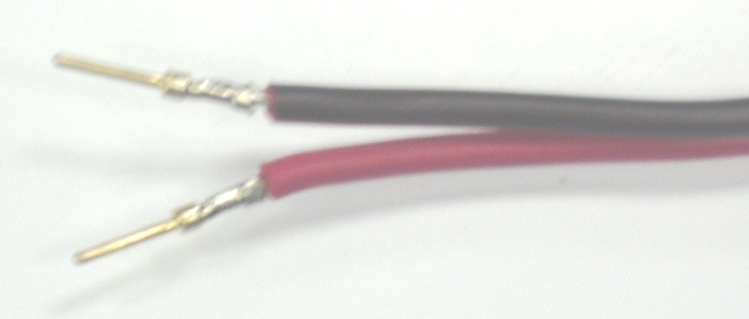

i'm getting started with datalogging. as a first step, i bought an aldl cable from affordable fuel injection.

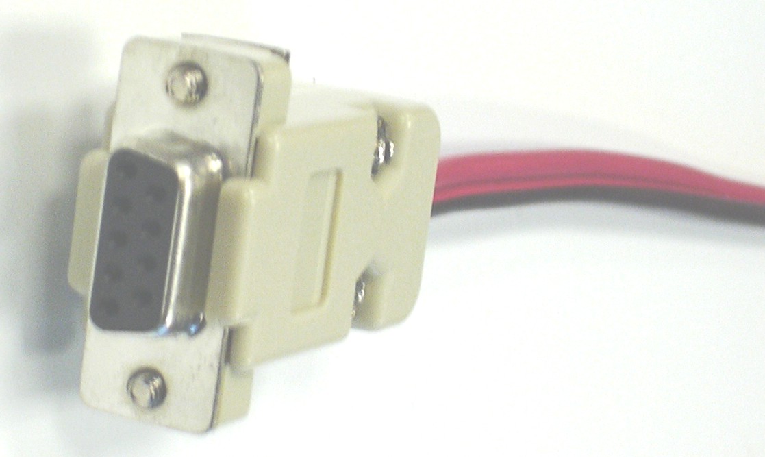

anyway, i work at a radio station. i printed out a diagram of the winaldl cable from one of the posts on here and showed it to one of our engineers. he opened up the serial port connector, compared it to the diagram and said it looked right.
one problem i see is the cable itself appears to bee too short to be able to plug in, set the laptop on the passenger seat or floor on the passenger side and drive around. the cable itself appears to be simple 18 gauge speaker wire. would i experience any problems if i lengthen it?

i was a bit disappointed in the "business" end of the cable. i'd think it'd be a lot more stable if it terminated in a connector end that plugged directly into the port, rather than having to stick two wires in there. is there a simple way to put that kind of connector on there? if so, where do you get one?
which jacks on the aldl port do these ends plug into?

black wire goes to pin a - which is top rightmost pin of aldl connector
red wire goes to pin e - 2nd from left on the top row of aldl connector
No problem with lengthening but i just push the passeger seat all the way forward then rest the screen on the dash.

the pin to ALDL interface is secured with 4 inchs of duct tape. removable/recycleable. works well..

Grump has his own personality, sense of humor. dont be offended. he will be the first in line to offer you assistance. and honestly that is how my pins are secured. duct tape.

He's right with the pins. I just plugged mine in and left them in, then routed it through the dash into the ash tray. When I want to datalog, I just open the ash tray and plug in a 6' serial port cable and rest it on the passenger seat. Works great, I don't have to install it every time I want to use it and I don't always have to look at the end of the cable dangling from my dash.
