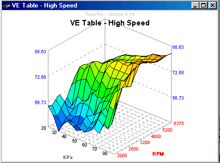

Newest tune...emissions. I'm not passing them so far. I found that my cat is trash after 4K miles, so evidently that happened while I was learning to tune. It never really ran lean or too rich, so I'm assuming it was it's because it's a cheap cat and I beat the truck every time I drive it, so I guess it is "rich".
Anyway, put a new cat in and luckily I have access to a 4-gas analyzer. I installed my NBO2 and evidently there is something wrong with it because it reads lean when in fact, it is rich. This could be a prop gain adjustment I guess, but the sensor is a Bosch sensor out of a Kia and I'm not sure if that in itself is a problem. After I noticed what was going on, I put the bin back into open loop.
At first, I'm passing idle emissions with flying colors, but failing cruise by a lot. I try leaning it out to the point that it surges, and then added some fuel back. When I hold it at 2500 rpm, sometimes it coughs and dips below 2000 when the pedal position hasn't changed. Also, after removing fuel from the VE - high table only, now I fail idle due to too much fuel. Why? I don't understand why adjusting only the high table would affect the idle while running open loop.
After the batteries in my laptop died, I started looking at other things. At idle, the fuel pressure on my VAFPR was only at 6psi. I'm not sure why, but when I set it initially it was at 11. When I rev the engine up, the pressure goes up to about 15, then back down to 11. I know the pressure isn't linear on these things, but that doesn't sound right. Possibly the reading is skewed because the engine is free-reving??? If I disconnect the vacuum line, the pressure goes up to 18 as it should. The pump and aeromotive regulator are new within 4K miles. The vacuum reference for the regulator is tee'd into the same line as the MAP sensor since I believe that is the only manifold port off of my Holley TB (injectors are GM 74# injectors).
Any ideas or things to try?

I have no clue what is going on. My Dad, the old-school drag racer, says I need to dump the TBI and switch to carb. Each day that passes, I find more stuff that isn't working right and I'm starting to think he's right.
Used the gas analyzer today and noticed some more things. It's still rich. If I multiply the high-VE table (since I'm trying to tune at 2500) by .9 (removing 10% fuel), it surges. I don't understand why, but I did a datalog and saw something else I don't understand. When it surges, the sync PW drops to 0, and one time frame later, async squirts some fuel (1.7 ish). The VE is 30, MAP is 29-30, RPM is 2400. Sync PW before this happens is 1.25, but the constants for async tell me that there shouldn't be any async at all. I haven't touched the tables from the original EBL bin, but here they are:
async transition lo:503
async transition hi:701
async high rpm: 6375
async low rpm: 6375
async high map: 99.69
async low map: 99.69
What the hell is causing this?
Another thing I noticed. When I'm failing emissions miserably (5-6%) and it's not surging, the sync PW is only 1.3. How is there that much fuel if the PW is only 1.3? I'm thinking too much fuel pressure or my BBC injectors are just too large for my fuel requirements. They are only 74#, which is only 6 lbs more than the original injectors.
I haven't moved the vacuum reference yet, in case anyone is wondering.

It is difficult to pass emissions in O/L as the cat-con isn't happy. This is why when in closed loop the AFR oscillates around stoich (or close to it). The cat requires the constant rich/lean change to operate. This oscillation is part of the fueling algo, it is done on purpose.
For drag racing only a carb would be fine. But I don't think it will come anywhere close to passes emissions. Unless an electronic Q-Jet is used. But that brings other issues to the table.
For figuring out emissions, you need to look at all of the gases: HC, CO, Co2, and NOX to see what is really going on.
High HC can be from either too lean or too much spark timing or both. High NOX is from no EGR and/or too much timing. High CO is from incomplete burn.
To disable the async injection mode zero these two:
async transition lo: 503
async transition hi: 701
The reason the sync PW seems to be too large to go into async mode is: the WUD reports the total PW, after all compensations have been made. This is the PW as programmed to the injectors. The async transition parameters operate only on the fuel portion of the PW. That is the PW from the fueling calc, before the compensations are made.
RBob.

Carb'd vehicles have different emissions requirement levels. The factory jumped through hoops to get things to sorta' work. The biggest gain was with greatly (!!!) reduced timing. Then came the 'E' carb's with the MCS's and all kinds of thermo-vac switches. Remember those cars? No spark advance, no compression, no power and no fuel mileage.
And yes, the guts in the cat's have changed over the years.
My Dad is certified in emissions and he only said it was way too rich, so I guess the other numbers are in line. He said it's showing that it's way too rich, but said the PW didn't make sense because it's not dumping that much fuel in. If what WUD is showing is different than what the injectors are firing, then that could explain it.
The WUD shows exactly what the injector PW is, at the injector.
I would suggest that all gas PPM's be posted. You can't look at just one.
Maybe there is a lean misfire, which will drive the HC through the ceiling. Too much spark advance will do the same, drive the HC through the ceiling..
I'll try disabling the async to see if that helps, but do you think there is an area of the PW formula that is off just enough that when I try to lean it out it turns the injectors off?
Disabling async will get rid of the surge.
There is nothing wrong with the injector PW calculations in the ECM.
Although the injectors themselves won't open if the PW isn't large enough. And no, I don't know what this PW is for every injector, voltage range, and fuel pressure.
First get rid of the async injection mode. That will stop the surging. This is a known. Then go to closed loop and get the AFR oscillating, that too is required. Then get the gas analyzer results and look at all of the gas PPM's.
If the CO is high then the burn is incomplete. Reduce the timing and richen the mix a little (via the O2 window tables). Then check again.

Async mode can also kick in once the PW gets too small. That is what the transistion PW's are for/ By making them both 0 the ECM will remain in sync mode.
The async mode for short PW's does not provide the same exact volume of fuel and the fuel distribution leaves something to be desired. Which is why it surges. The math is correct to covert from a sync PW to an async PW, but comes up short when the compensations are factored in.
So once the injector flow rate is increased it is best to just disabe async mode.

Old Oct 29, 2009 | 01:03 PM
  #889
andetodd's Avatar
Joined: Aug 2009
Posts: 15
From: San Diego, CA
Car: '89 IROC 126K 2nd owner.
Axle/Gears: 3.08 limited slip w/ aluminum shaft
Re: Tuning with the EBL Graph Axis
In TunerPro, when I view a 3D table graph, the surface appears sideways.
I think I just need the kPa numbers to go in the opposite direction, does anyone know how to get the axis to do this?
Is there a different version of TunerPro I should be using? I'm on Windows 98 using TunerPro version 4.14
One other thing - if you feel like suggesting a couple angles I should consider in smoothing these VE tables out, feel free to chime in.
Attached Thumbnails Tuning with the EBL-ve-low-orig.gif   Tuning with the EBL-ve-low-bumpy.gif   Tuning with the EBL-ve-high-bumpy.gif
Old Oct 29, 2009 | 01:18 PM
  #890
Ronny's Avatar
Joined: Mar 2003
Posts: 6,880
From: wisconsin
I lately used .90 for TP. .80 will smooth to greater degree.
I find the .90 or .80 does not make much of a change in surrounding cells which may ge a good thing.

Old Oct 29, 2009 | 04:44 PM
  #891
RBob's Avatar
Posts: 18,432
Likes: 235
From: Chasing Electrons
Car: check
Engine: check
Transmission: check
You can rotate the graph by holding the Ctrl key down, then left clicking and dragging.
As for additional smoothing. Use the WUD and start a VE learn. Set the smoothing factor as required. Then just stop the learn. Basically, start a learn then just stop it. The smoothing will be applied to the current VE tables.
Note that in the Low Speed VE table the triangular area of low MAP and low RPM can be flattened by hand. No learning takes place there so it is best to reduce that area until even with the surrounding areas that did learn in.
RBob.
Old Oct 29, 2009 | 06:08 PM
  #892
andetodd's Avatar
Joined: Aug 2009
Posts: 15
From: San Diego, CA
Much appreciated. I've now found the graph rotate directions in the help file as well. The shift and zoom functions are working, but the graph rotation is not. I tried by clicking with the left mouse button while holding ctrl, and I tried using control and the arrow buttons. Same thing - worked for shift and zoom, not rotate. Anyone else have this problem?
I tried using an older version, was able to find TunerPro 4.12, still can't rotate. Anyone have version 4.0 or something similar?
