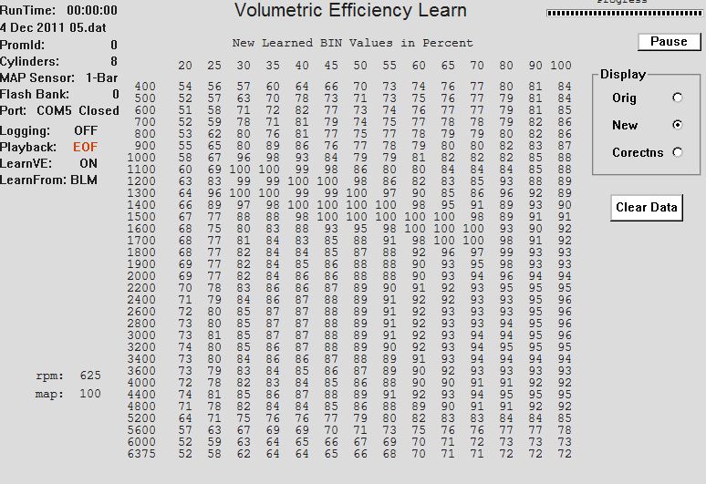

Originally Posted by Ronny
What are your VE Learns looking like?
Here's latest VE learn (same as seen on VE low and high speed charts)
Attached Thumbnails Another EBL Tune Thread...-ve-learn-12-6

now show the %%

You mean the corrections? Here are those: (from first learn to second learn)
Attached Thumbnails Another EBL Tune Thread...-ve-learn-percent-12

It is adding a lot of fuel. eventually it will start to level out with some minus appearing. Change in temperature day to day will cause corrections as well.

That doesn't sound very good- especially since I clocked 16.5 mpg before that learn.
I entered 11psi for my fuel pressure because I'm not sure exactly what it is- could this be affecting it in a big way?
I was also running a code 23 (IAT low) because I disconnected the sensor and didn't get rid of the flag until now

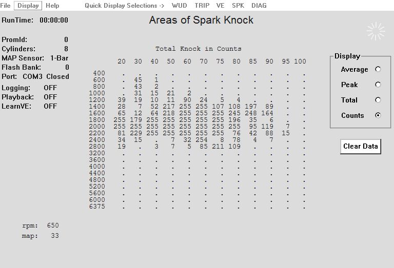

Now it's been running a lot better, but I plugged in to get some datalogs and logged a SA that looks like this over a 4.2 mile trip (city)
Also, my gas mileage seems to have gone down a bit since I fabricated my CAI. It draws air from a filter located where the cruise control module used to be. Then again, I don't have the IAT hooked up properly yet- going into the TBI hat. I know the TBI likes the intake air to be little hot, but I don't see why CAI would cause roughly a 2mpg drop.. especially in the summer when the air is already hot.
Attached Thumbnails Another EBL Tune Thread...-spark-knock-count-7   Another EBL Tune Thread...-spark-knock-average-retard

Sorry to bump again, but are there any suggestions on what to do about the large amount of spark knock I'm getting? This car is my daily driver so I can't afford to mess it up.

Pull some spark pugs out and check them for signs of detonation. See this link:
www.dynamicefi.com/SparkPlug.php
That will show you what to look for. If it is false knock it is killing your performance and mileage.
RBob.
did you pull a significant of SA incrementally? You should see improvement as you pull SA.
I would pull 15% at a time until you see an improvement. If no improvement then odds are its mechanical.
I did just that and saw no improvement. My KC are at 2400 rpms 35 to 45 MAP and no wheres else. They appear out of nowhere one in 5 logs. During moderate accelleration like an xway ramp. My plugs looked normal cept cyl #2 had oil fouling last year. I am at 2 deg max retard during event. If fact I may just zero out the retard table. Not sure if it will still show in datalogs then?

@RBob. Pulled 4 spark plugs and none of them have peppering like the pictures you have. There's some discoloration, but I'll assume that's from normal engine wear after nearly 1000 miles, with a handfull of those miles being with bad timing and rich conditions. I'm going to try filling up with 93 octane to see what happens. I'll also look for sources of false knock-could be my exhaust for all I know- I haven't been tightening that like I should.
@Ronny- What exactly do you mean by pulling SA? Obviously, I haven't done this so please tell what you can
Edit: Took a second look, and I can see some peppering (yes, purple too) on the spark plug from cylinder number 2. This is most likely due to a hot spot I created when I scraped the heavy carbon deposits off the top of the cylinder with a screwdriver.. idiotic, I know now. However, this peppering is very light and barely noticeable. How should I go about dealing with this?

After work I took the valve covers off and checked the preload on the lifters. I tightened two up, but for all I know I could have 14 more loose lifters causing false knock. Since I have nothing better to do tonight, I'll try to re-check the load on all the lifters after I change the oil. 3/4 tank of 93 octane doesn't seem to have helped much either.
Oddly enough, looking through my old datalogs, even when the engine was stock (and in pretty bad running condition), it was recording a lot of knock.
Attached Thumbnails Another EBL Tune Thread...-spark-knock-count-713.jpg   Another EBL Tune Thread...-spark-retard-total-713.jpg

Should I be using the L98 SA tables instead of the Vortec tables? The combustion chamber of the 059 Vortecs is D shaped, rather than heart-shaped
