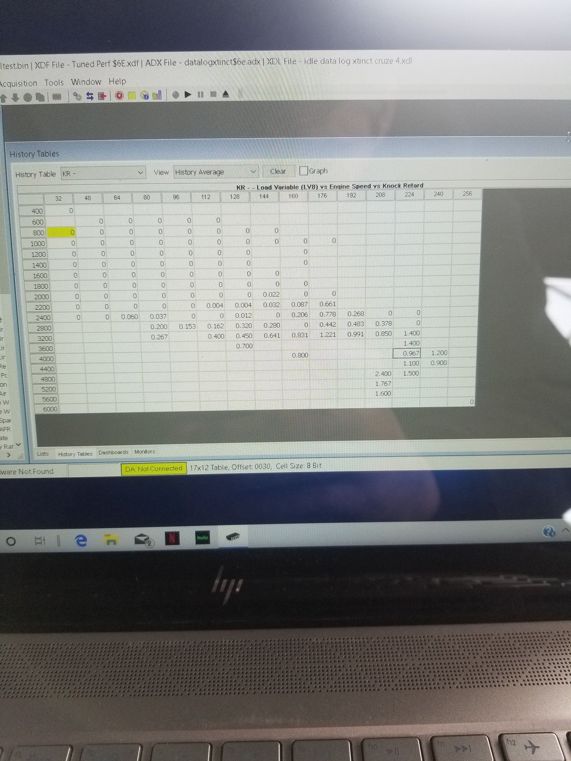

I think this is all false knock... this is my KR data from before i took 4 degrees out.
And this is after..... ill post an actual log on it for you all... just want to make sure im doing it all right.
this is what my blms look like.......

11.2:1 with vortec iron heads and that cam??with tpi? I dont think that’s necessarily false knock. Thats way up there on cylinder pressure with iron heads
try another 4 deg out and see if it goes away. Maybe target slightly lower blm for abit more rich condition

Ok, so took a scan of it this morning and wow it really cleaned up.... ill post it when i get somewhere with internet(im a truck driver/hazmat fuel hauler...)
Ill post the log..... here is a pic of what it looks like now though..

I took that other 4* of timing out all across the board, is it suppose to get leaner when i do that?
Also when i attempted to make it more rich, she starts shaking. Also the knocks came back when it got richer.. can you shed some light on that? On why.. i guess it doesn't quite make sense to me.

Been working on it for most of the night.
I ended up taking 3* more of timing out.......
Here is how its looking right now.

When timing is pulled, burn happens later and can be incomplete going out the exhaust. Giving impression its lean as theres unburnt air.
richer and shaking maybe its missing? Seems odd it would do that. Go by feel tho and give it what it wants to run best at
