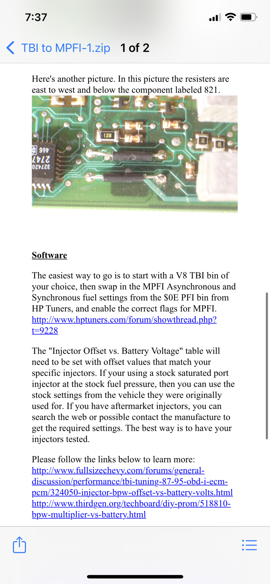

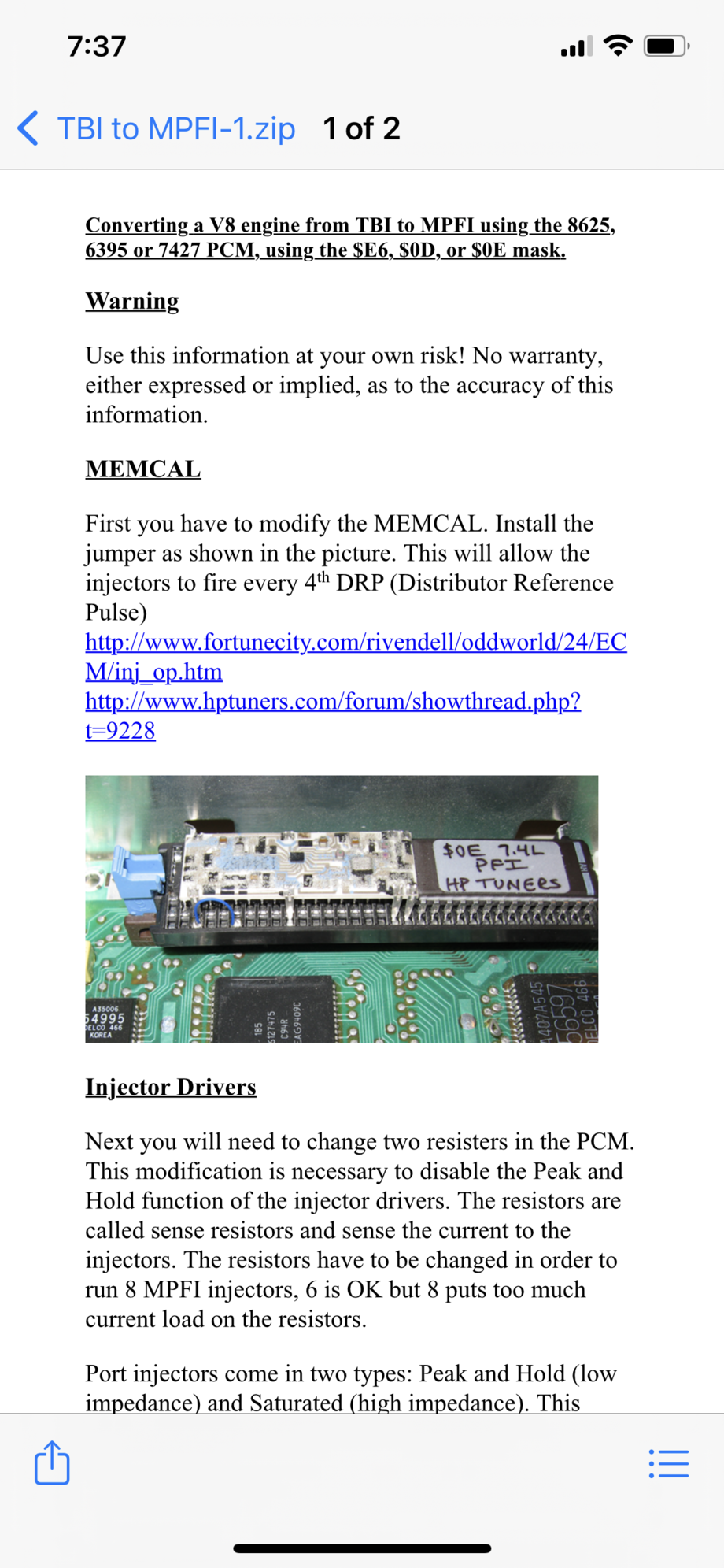

Gearhead efi has a great write up on the batch and doing a starter binary.
Thanks! I know the site well, was how I did the hardware mods to the 7427. Must have missed the part on setting up a starter bin, will dig back into it!

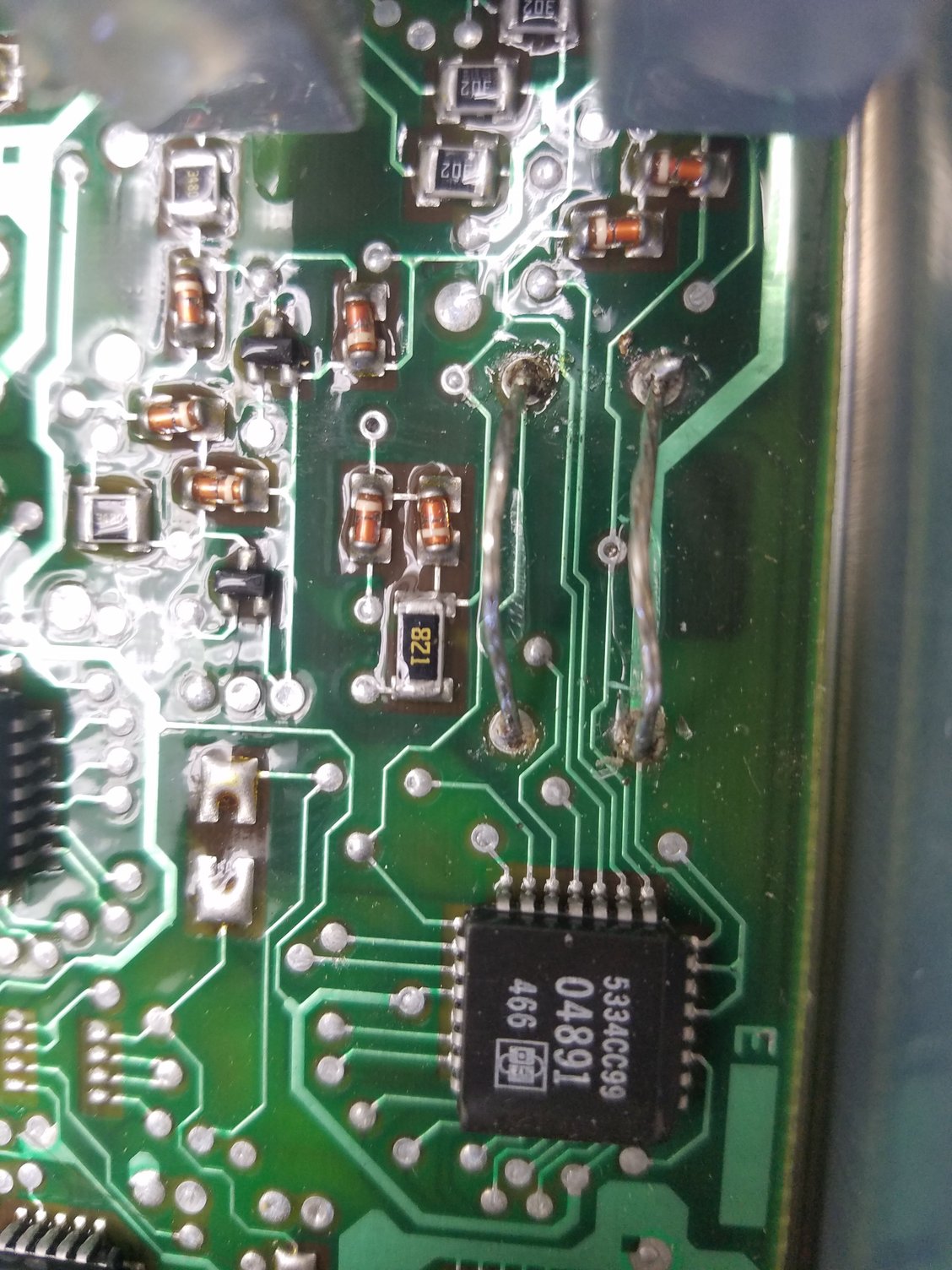

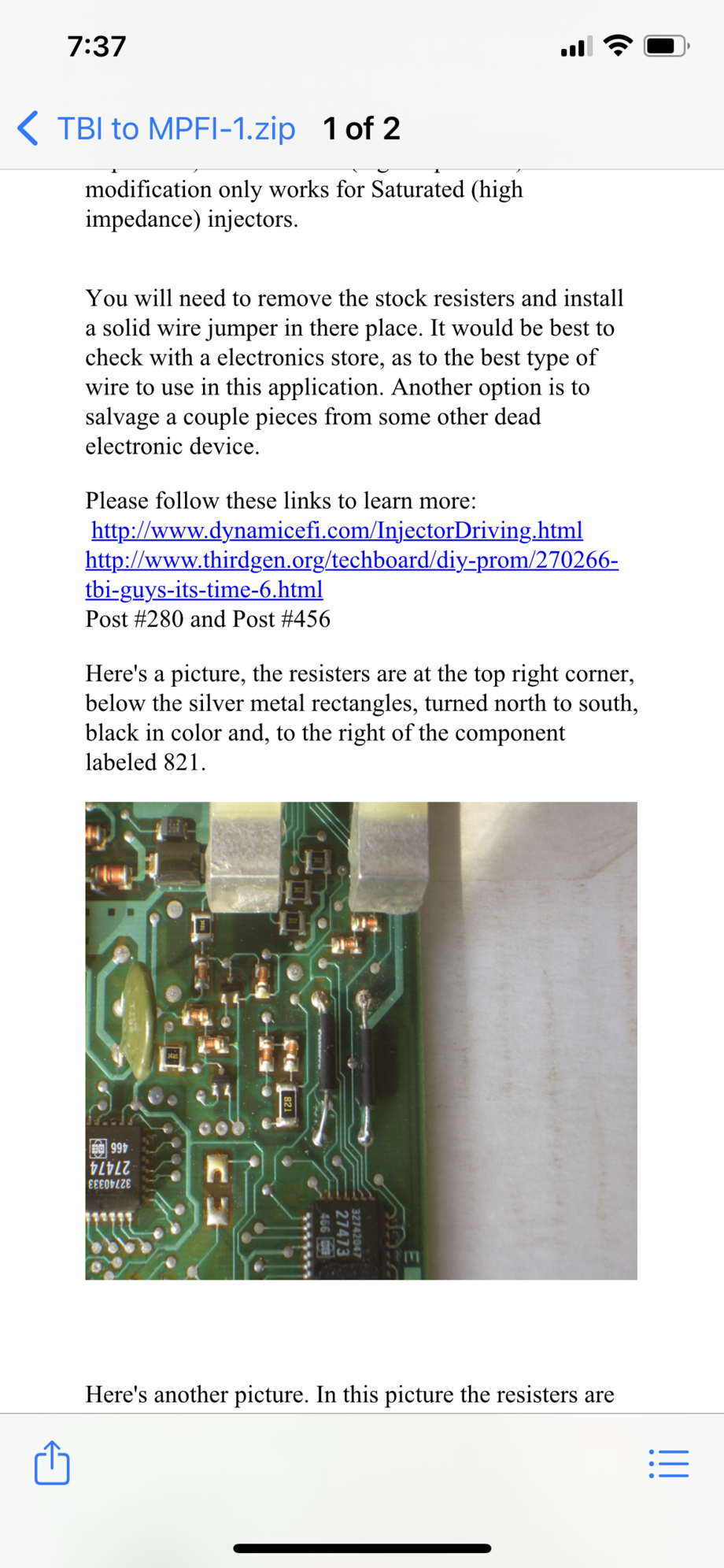

The easiest way to deal with the sense resistors is to solder a jumper across them. Use a heavy gauge (16 - 18) solid wire and place them on the bottom of the board. Be sure that they aren't too high as to touch the case.

WJen I modded this ECU a couple years ago, I removed the resistors and soldered in solid wire. Hindsight, wish I had just jumpered the resistors as you suggested. End result the same, at least. They were a bear to remove!
