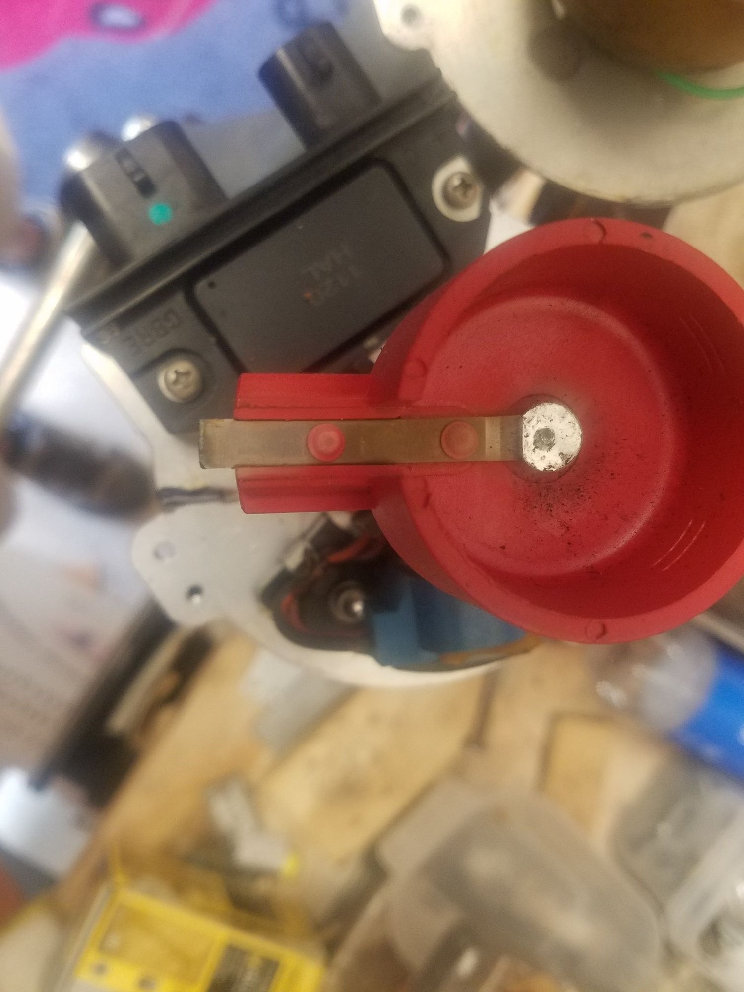

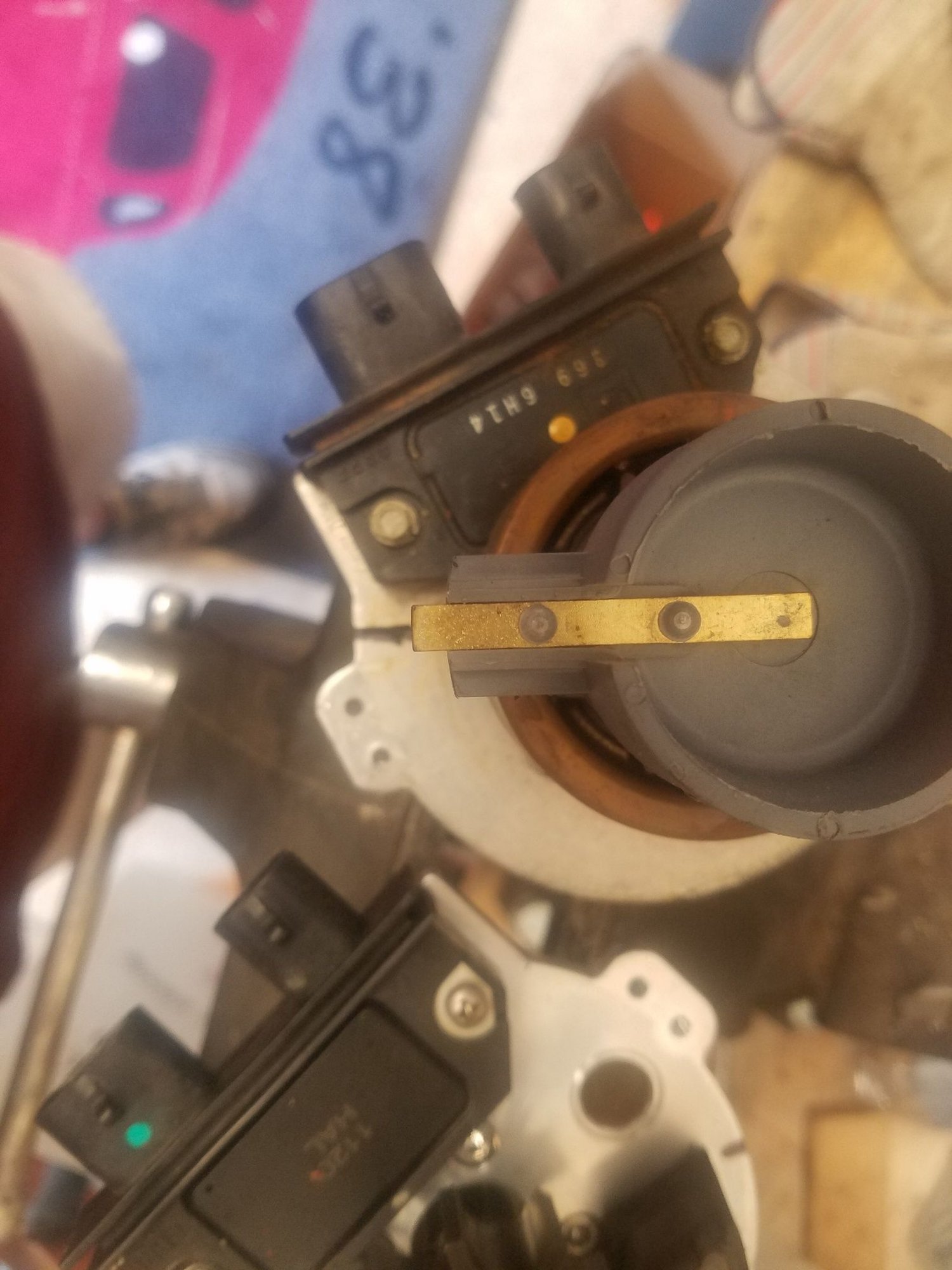

1. Tune 151 had the OEM distributor. Latest run used an MSD that looks to me to have serious phasing issues (but not according to the MSD tech)

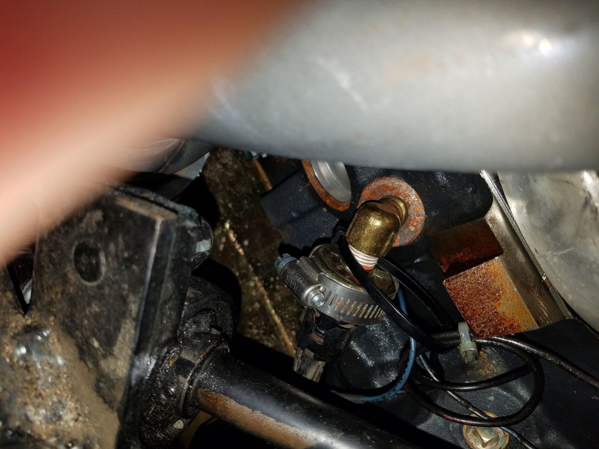

I cannot say that I have resolved this issue. Candidly, I am not sure what to expect from a "stable" RPM. I have attached excerpts out of the last two logs. One at 73 mph and the other one at 46 mph. In both logs, the TPS is constant. But you can see some variation in MAP, BPW, RPM and VE from table. The VE from table is probably driven by the change in MAP, but who knows. I have Highway mode bypassed in both logs until I get the BLMs to tidy up. The distributor is the GM small Electronic with a new gear and a new module. New AC Delco coil. I have not done anything with spark latency relative to the ICM. Not sure where to get that information.
I had a heck of a time with bogus Knocks. Finally, removed the knock sensor and wrapped about six or seven wraps of teflon tape on the sensor and screwed back in until just "snug". Ran a ground wire from the engine block to the sensor and attached it to the outside of the sensor with a stainless hose clamp. No knocks. Moved the timing up 2 degrees across the board (above idle) and still no knocks. Will stay there for the time being. Both these excerpts from logs are with the advanced timing.
Suggestions?
Don
File Type: pdf
File Type: pdf

Interesting thing you did to knock sensor
Would that disable it to a certain extent?

Knock Sensor: I was getting KRs off idle, KRs when encountering Decel (in and out), at low MAP, etc. This is a big HP engine stuffed into a 1938 body and chassis (modified some). Lot's of opportunity for vibrations and such. Dropped SA by 3 degrees across the board. Still had some KRs. So, did the wrap thing. I figured the extra teflon would prevent a good ground, hence the separate ground wire. See Photo.
Distributor: I was never comfortable with the MSD on the phasing of the rotor. When you aligned the magnetic pick up on the rotor and compared that to the location of the pin on the cap for No 1, it appeared to me that the rotor was well past number one when the magnetic pickup would fire. I never cut the cap to see what was really happening, but I did compare the alignment with the OEM distributor. I called MSD and they said it was supposed to be that way. That didn't jive with me. Seemed to me that even clocking the distributor body enough to get 10 base timing would move the phasing even further away. I guess I could be all wet here, but I had the OEM and decided to eliminate the MSD as a possible contributor. See photos. Red Rotor is the MSD.

BTW, that knock sensor was meant to work with a 350cid (4" bore) or maybe a 305cid (3.73" bore) depending which motor the sensor came from. It was certainly not design to work with a ZZ502 (4.47" bore). IMO, I would not bother with it.

I had tried a few other KSensors with different parameters (like for a 454) and they didn't work at all. Engine wouldn't run. De-sensitizing it seems the way to go to get rid of all the KRs.

Old racers trick, "desensitized" knock sensor. It really helped in the days before tuning wasn't known as well as today

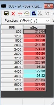

Originally Posted by Sharp38
That could also explain some performance differences between the OEM small top distributor that I am running now versus the MSD. The ICM I purchased is AC Delco 19179578. I think it is the same as the ICM that was in the distributor when I got it in 1995. Is there any place where the results of various member's latency tests have been accumulated so one can avoid having to run their own dial back tests?
USE at your own risk. I personally tested this on my own cars. I still recommend you do an SA latency test to confirm everything.
The OEM SA latency tune is not accurate. That's why you'll notice total SA at WOT has a weird convex curve to compensate for it. The curve got worse with years. Maybe GM tried to correct it that way. So if you recalibrate your SA Latency table, it will pull timing at certain RPM. On my OEM $8D, it was off by up to +6*!!!!!!!
This table is for 1989 OEM HEI distributor with remote coil (ICM 369) operating on $6E, 165 ecm
This table is for 1991 JEGS #555-40006 distributor with remote coil operating on $8D, S_AUJP, 7730 ecm
