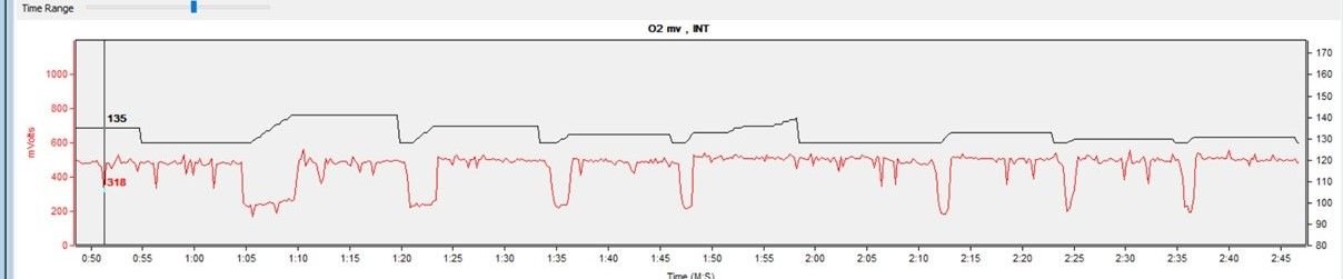

What I am seeing is both of your logs are behaving the same. The only difference is V4 gets more CL and O2 voltage goes lower but barely crosses 500mv. It is in and out of CL. Engine is closer to operating temperature. In V6, the O2 sensor voltage is flatter and barely any CL. However, engine was warming up
Picture is from V4 with O2 voltage and INT. V6 's O2 voltage is flatter than that.
This is not normal. May I suggest you try swapping the O2 sensor see what it does?

Not enough proportional gain. The ECM is using the INTegrator to create x-counts.

Interesting! And what would be causing "not enough proportional gain" using 3 different versions of S_AUJP out of the box? Thanks!

My guess is that the injectors are smaller then when the tune(s) were set up.
