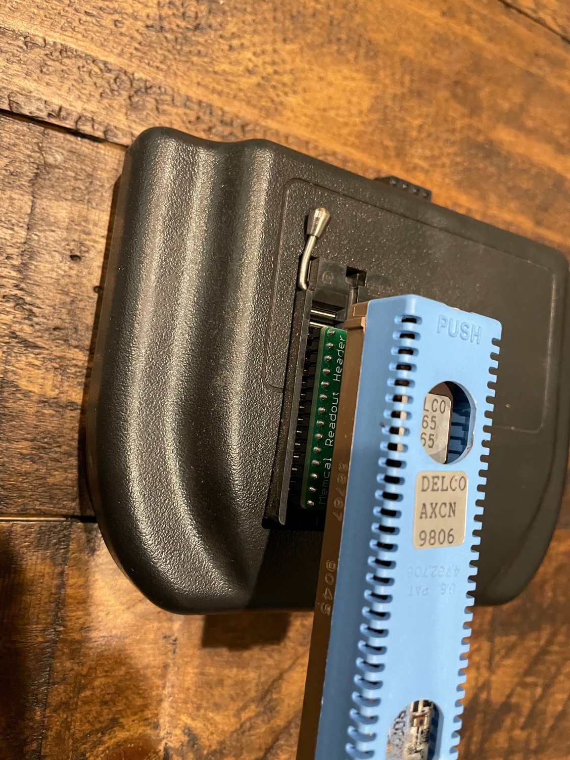

Once you get the header this is how it installs. If you have issues reading let me know might have to enter in offsets in flash and burn program.

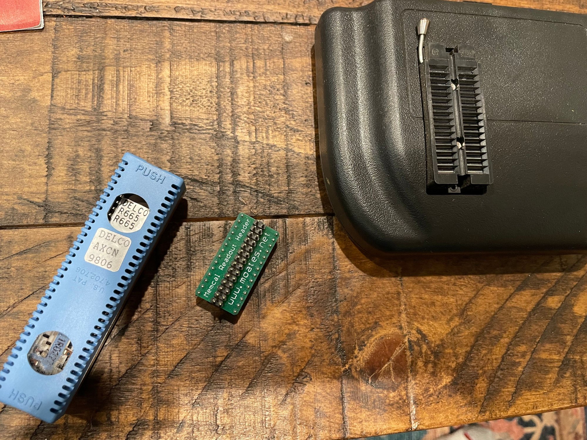

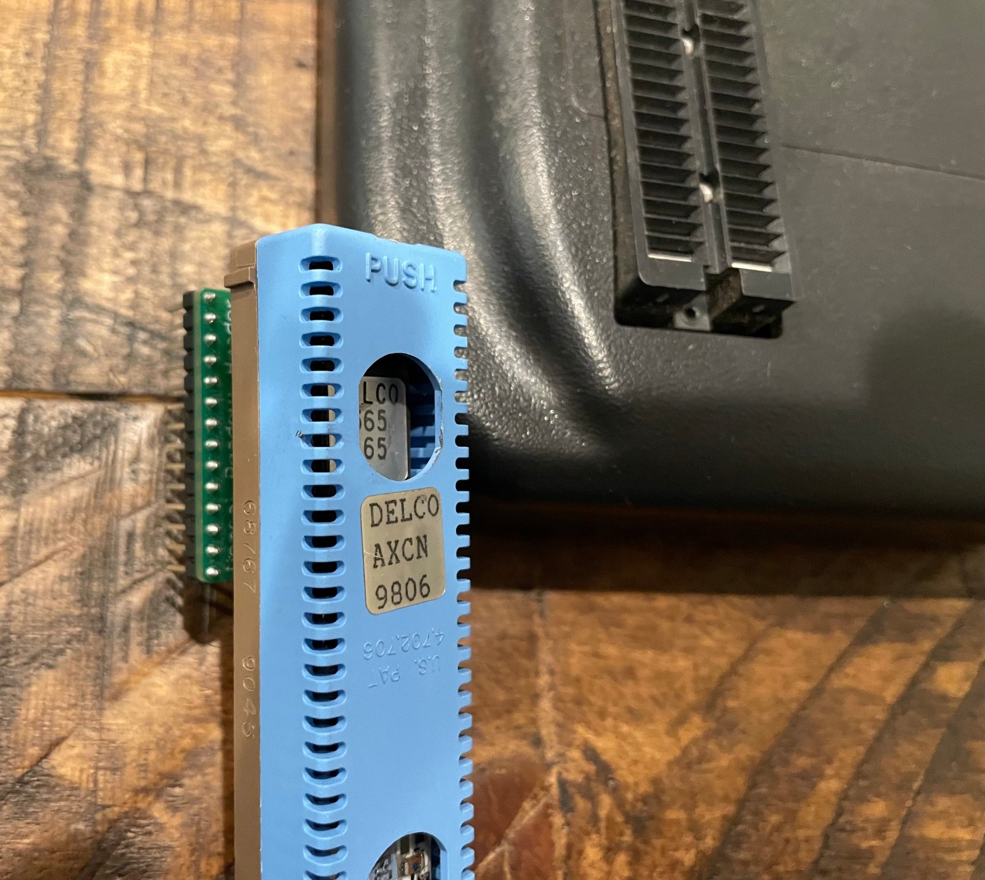

Hard to tell in this photo, how many open spaces are there from the handle?

First 28 pins are used out of 32 iirc
