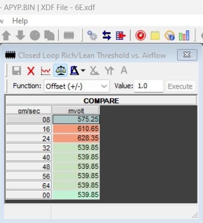

“In the rich/lean offset table, are those millivolts the stated "swingpoint" to determine what's rich or lean?
They are used in closed loop operation only to determine rich/lean condition. They are used for Integrator (INT) and BLM calculation. They have no impact in open loop or PE (WOT) condition.
“If I moved each value up, would it get richer? (or leaner?) When I look at an online graphic of lamda vs millivolts, it LOOKS like higher voltage means richer I'd think it would read oxygen and be getting leaner?”
Higher = richer, lower = leaner. I would not temper with those parameters in the tune for now. If BLM’s are too low/high, generally, MAF tables need retuning, but not necessarily.

BTW...I notice ARAP (rich/lean threshold) has higher values for lower MAF flow -- than the Corvette's AYPY stock BIN (as found online). I'm thinking the ARAP is an automatic BIN vs a manual bin for the AYPY. Since an automatic aids in torque conversion (torque converter), I'm almost think THAT is backwards too! :-) I'll post them if you're curious.

The only way to see if BLM is out of range is by datalogging and looking at the actual number.
Factory ARAP/AYPY = 108min 160max
They can be changed to accommodate more correction. Problem again with BLM is they can swing wildly. Follow the Integrator instead.
What do you mean by rich/lean threshold? It's a confusing term. There are no rich/lean thresholds in the MAF tables.

Rich/Lean Threshold tables for your perusal....
Notice the differences in values between APYP and ARAP. And, yeah, the differences MIGHT be attribute to trans type...meaning some need to enrich lower air flow (rpms/LV8s) to perform richer/leaner depending on trans type. TO ME, it would appear manual trans requires less of a "boost" to launch the vehicle (or lightly accel) compared to auto (ARAP). I make this guess because ARAP's higher voltage thresholds imply a richer target -- in closed loop.
Which is to say I'm assuming it's possible to alter AFR even in closed loop. If I'm right, that's what you weren't understanding when you thought I don't get closed loop vs open loop.
