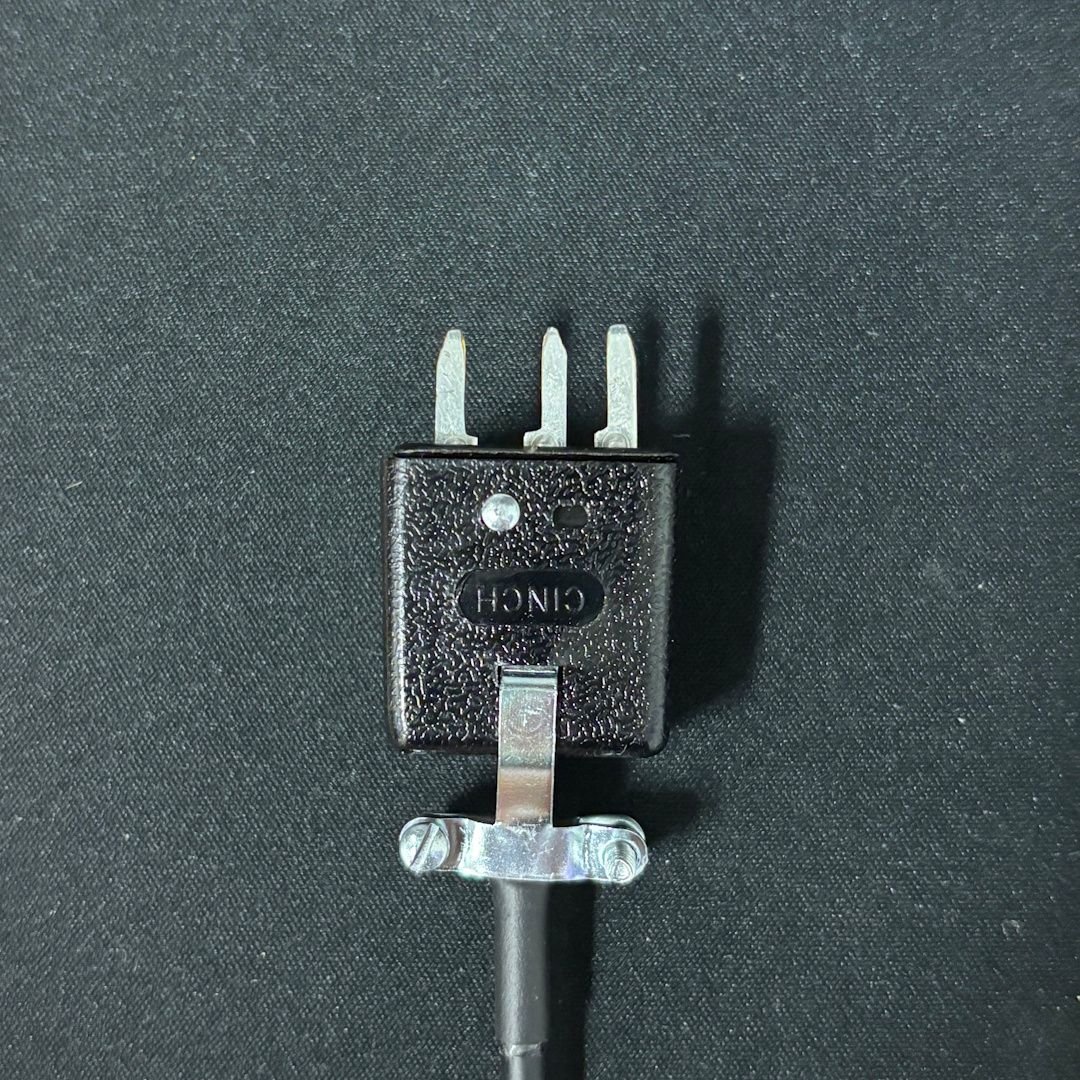

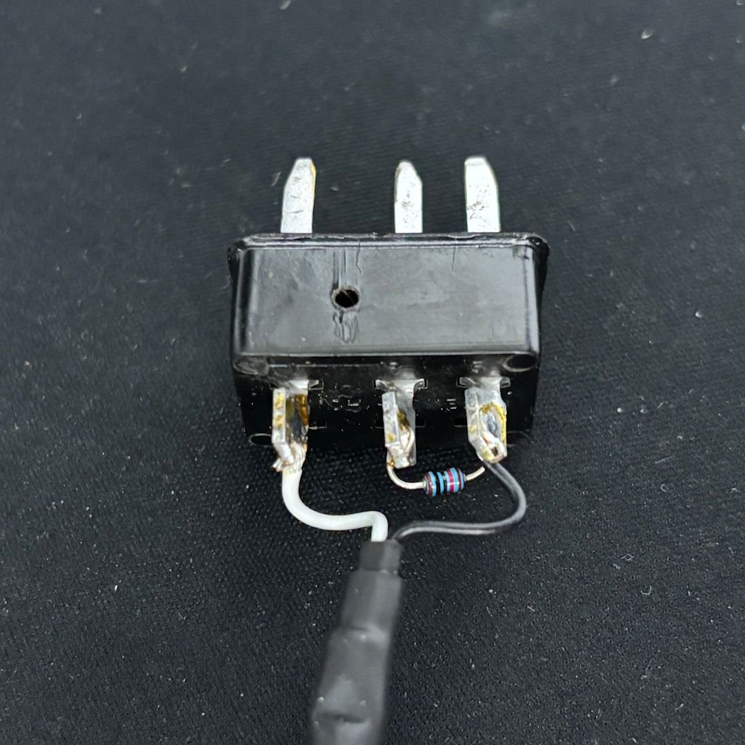

The 6-pin connector came unassembled. I removed the bottom pins by straightening them with pliers and pulling them out from the front. I had to grind the remaining pins with a Dremel and cutoff disk to fit the ALDL port spacing for pins A, B, and D. Most GM ECUs use pin E for the datastream, but the 8079 is one of the ECMs that uses D. A file would have also worked since the metal is pretty soft. I soldered a 10k ohm resistor directly between the A and B Pins. The Black ground wire is soldered to pin A, while the White signal wire was soldered to pin D. I used two pieces of adhesive lined heatshrink to protect the wires from the little clamp that keeps them from getting pulled out.

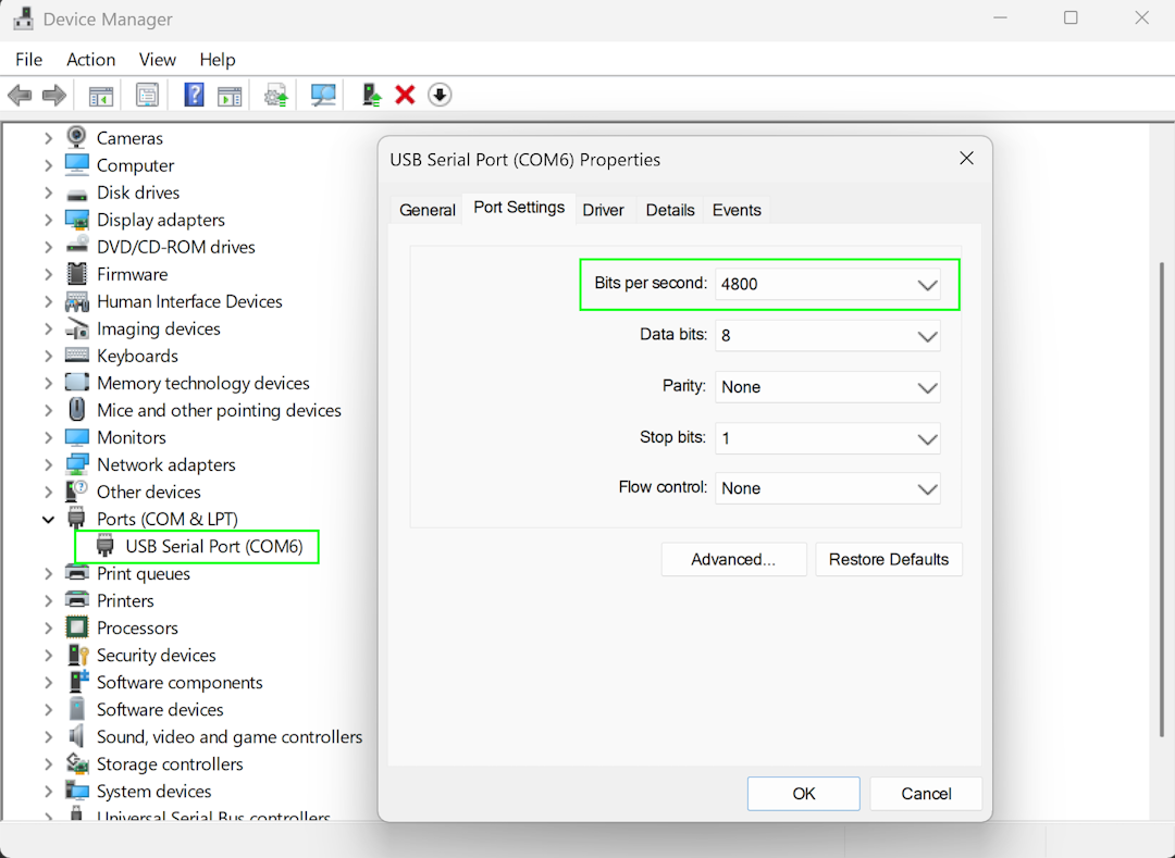

I installed the VCP Driver on my Windows laptop then plugged in the USB cable. (DON'T plug it into the car yet) I found the adapter in Windows Device Manager and set the rate to 4800. Fired up WinALDL, found the correct config settings and fired up the car. Plugged the cable into the ALDL port and started seeing data! Works in TunerProRT too.
