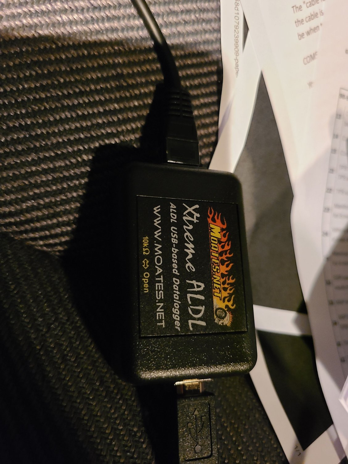

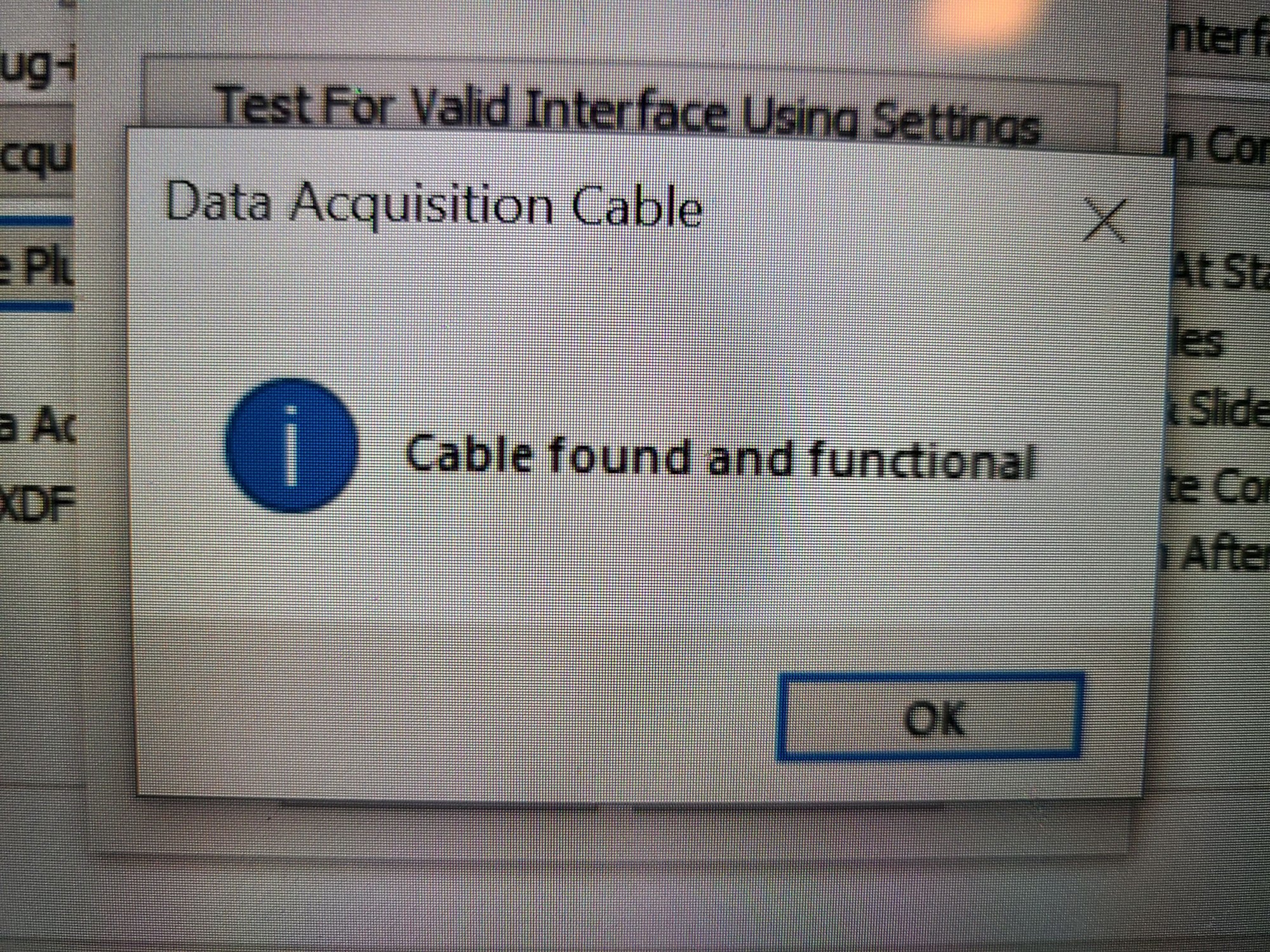

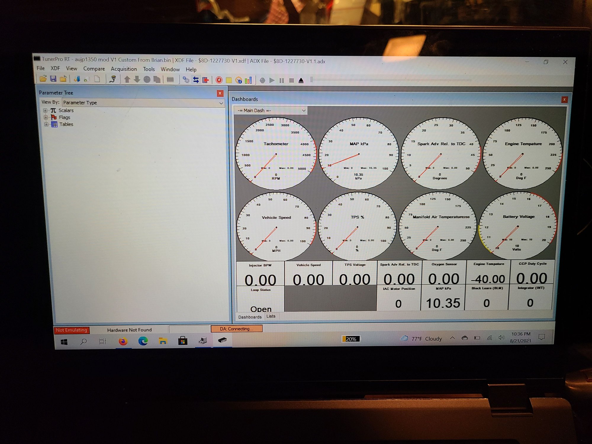

Hey All,
I know this topic seems to have been covered before, and I've read all of the related threads I could find. If I missed a good one please link me, but I have found nothing to solve my problem. I have been working with my tuner, and with the CS at Moates, and they have all been very attentive in trying to help me, but I'm thinking the more eyes that look at my situation the sooner I will figure out the solution...
Problem: I am unable to get my Moates Xtreme ALDL to Connected to ECU in order to datalog my current tune. I am using the Cable 1 also from Moates to connect to my OBD1 port. This is on a 1991 Z28 350 TPI.
Tests/Results:
- Connected using instructions from Moates. Completed all setup steps, confirming ports and other settings. Completed the Data Acquisition Cable Test. Getting a positive result weather the ALDL is connected to the running car or not.
- Continuity checked between all wires on Cable1. Continuity checked between Data cable in OBD1 port and connector on ECU. All checked out fine.
- Xtreme ALDL replaced, but with same results on replacement. Moates CS had me run a bunch of tests and they couldn't find anything else wrong...
- Both USB ports on Laptop tried, both reference the same port number, and have the same result.
- Waited 30 seconds for it to connect but never did. How long does connection usually take? Tried repeatedly trying to connect and disconnect in hopes it would work one time, read somewhere that this can help, but didn't in my case.
- Most recent drivers installed for the Xtreme ALDL, all seems well with it.
- Car currently runs no problem and with no codes using the GP1 and current preliminary tuned chip. Did try the paper clip and successfully get only the code 12 about no spark pulses because engine is not started, just ignition turned to on.
- Tried 10k ohms and open on the xtreme ALDL, with same result... Suspect for a '91 I should be using open.
- Various ADX and XDF files tried in different combinations all with the same result.
WHERE AM I GOING WRONG??? Any help, tips, or things to check would be greatly appreciated!!!!
Many Photos hopefully to help someone notice my problem...
Status while trying to connect using the button with the two opposing blue arrows.
Status before and after trying to connect.
TunerPro RT 5 - Preferences
TunerPro Data Acquisition Plug-In Configuration
Data Aquisition Cable test result, while the cable is disconnected from the running car, and while IT IS CONNECTED!
Windows Device Manager
Windows Device manager Detail 2
Windows Device manager Detail 5
Windows Device manager Detail - Advanced
Xtreme ALDL itself
Connection to OBD1 connector
ECU with Moates GP1 Kit and custom chip installed.

I believe I have finished testing everyone's ideas and have results to share:
- I tried changing the com port to 1 and rebooted the computer, then updated the detail in TunerPro. This made no difference.
- I tried removing my GP1 with new chip and just reinstalling my factory memcal by itself. It made no difference so I put the GP1 and new chip back in.
- I tried connecting an analog volt meter between OBD1 pins M (Serial Data) and A (Ground) I was surprised to see a very smooth constant 12V. It came on with the ignition in the on position, and when I started the car, the needle never even moved the slightest amount, at least not that I could see. Was I supposed to be jumping the pins A and B also? Its strange, it almost looks too steady to be battery voltage, but I guess it could be. I do have two decent sized capacitors connected to my sound system...
- I have tried all of the following ADX files, none allow me to connect.
What else are we missing here???
Thanks for everyone's help! Keep the ideas coming!
-Eli

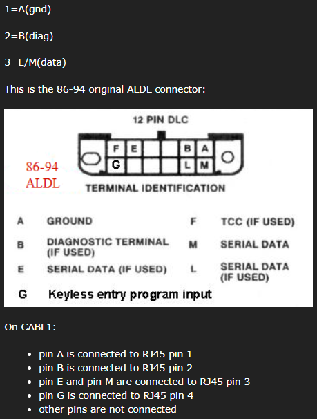

Yes the two right most pins. I can try a digital volt meter tonight and see if I get any different reading.
I thought though with an analog one, you should see the needle dancing around if data was being sent, my needle was perfectly stationary... Also, did I need to do anything to initiate the data flow? Jump a and b while the vm is connected to the data and ground pins, or something?
This is the Pinout I've been referencing. It is correct, right?

With the '90 - '92 f-body TPI MEMCALs, the only way to get data is to send a data packet request to the ECM. This needs to be done via the ALDL serial connection.
If you can get your hands on a scan tool for your car, it would be helpful to see if it connects.
Or, try your set up on a '90 - '92 f-body that you know the ALDL works.
RBob.

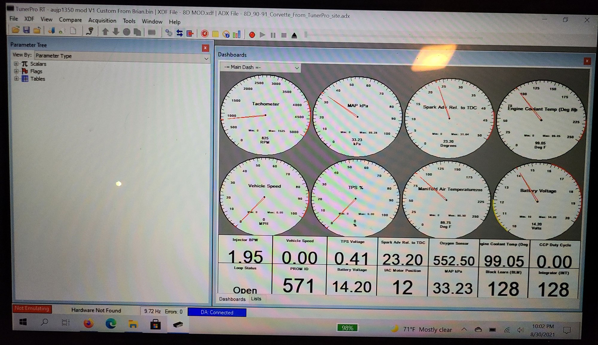

FYI, i have had some luck using the $8D_90-91_Corvette.adx, to connect to my 90 Y-body L98 car. Just try flipping the 10k switch back and forth. Make sure you start the TP-RT software with the cable and everything connected. Are you running the laptop off battery, or connected to some power source? Could have a ground loop.
Old Aug 25, 2021 | 08:23 PM
raptere's Avatar
Posts: 801
Likes: 91
From: Northwest Chicago Suburbs
Car: 1991 Camaro Z-28 (Durango R/T)
Engine: 383 L98 W/ HSR
Transmission: 700R4 Tuned Shift 2600 Stall
Axle/Gears: 3.73 10Bolt Posi W/ Al Cover, Disks
Re: HELP - No one can get my Moates Xtreme ALDL Connected to ECU - Pics of Everythin
I'll have to try that adx again... I'll also try hooking the power supply up to the laptop if that helps...I thought for a 1991 I shouldn't have to flip the 10k switch? When and how should I try it?
I did find my local Orileys has an old 1 scanner I'm going to go try it out now, any tips on what to try. I figure I'll see if I can view live data...
The 10k switch, puts in a 10k ohm resistor, to initiate datalogging. Try flipping, BEFORE you connect, and if it does not, just go back and forth with it. As far as power supply, i meant to run off the laptop battery, NOT connecting to some other power source, which could create ground loops.

Well, I tried all the above... no luck. I did recheck the voltage on terminal M and it is 5v not 12, I must have been reading the wrong scale on my vm... Oriley hat the tool, and the adapter, but was missing a special cable you need to connect the two, luckily the manager said if he couldn't find the cable by tomorrow, he would order a new one and call me when it's in.
The fact that my data terminal is reading the needed 5v, and I get the expected code 12 with the a-b jumped is making me think the issue is something on my laptop... I'm going to try loading everything onto my work laptop, and see if the results are any different...

Well, that was a waste of time, just finished reinstalling all the software on my work laptop, then retesting everything and it's all exactly the same... I'm starting to think it must be something about the procedure I'm doing, or the settings or installation process I'm using on my pc...
Also, just confirmed I do get the same 5v at the other end of my cable1, on I think it's pin 3. And, have continuity between the pin one and a random body ground, as I should.
Any other ideas???

Time for an update...
I was able to get to Orileys last night and try using their scanner. We hooked it up to the OBD1 port, and started entering requested data. Year = 1991, 8th digit of vin = 8, then it asked for the 4th digit of the vin which for Camaros should be F. This was not an option, so we selected other. It tried for a few seconds to connect, then gave an error saying it was unable to connect to the computer... We proceeded to try all kinds of combinations of years and 8th digit codes, and 4th digit codes, all with the same results...
It is seeming to me, that the ECU is just not sending any data to the M pin. The only other thing I can think at this point is trying a new ECU. Do you all agree? If that is the next step, am I OK just getting what I can get easily and quickly, and that if it doesn't fix the problem, I can easily return it in person, without having to worry about shipping? It looks like my options are Cardone (most readily available, tomorrow), BSE Origonal, MasterPro, or Napa.
I'm scratching my head a little bit, because the ECU itself has the words "top back" written on it in sharpie. That was not my doing, so it looks like someone has been in there before, which is strange, because when I bought the car back in 2003 or so, I was under the impression the car was completely stock...

I actually ended up ordering one of the Cardone ECU's from Orileys, and its ready to pick up tonight, so I'll give that a try. I'll have to make sure of the return policy first...
I also need to go and double check all my fuses. Everything seems to be working, but that should have been the first thing I checked, but I keep forgetting... Doubt I'll find anything...

Well... I checked all the fuses, they're all fine..
I guess when you've checked everything else, all that's left is the ECU... I just swapped the ecu with the Cardone one I picked up today, and like flipping a switch, EVERYTHING NOW WORKS! I did a bunch of datalogs tonight and they all seemed to go perfectly. I also tried a few different combinations of XDF and ADX files, and they all worked now.
Only remaining question is, am I ok with the Cardone ECU I got, or should I try and get an actual GM one? Different one?
