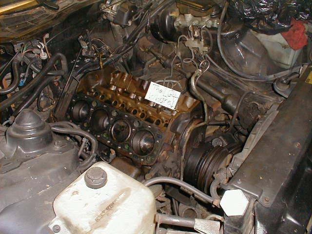

I'm currently modifying my engine and I need some advice.
I have an '87 LG4 and I'm junkin everything on the top end of my engine and putting in the following: Iron vortec heads, Edelbrock preformer RPM intake,700 CFM carter carb,heddman shorty headers with matching Y-pipe,Hooker cat back, Self aligning roller rockers, and so on.
I need help picking an ignition setup and money isn't a problem,
First I need to find a distributor, and it has to bypass all ECM or engine computer crap so what distributor typre should I get,Vaccum advance or mechanical.
I'll also consider an electronic ignition.
My car will also be lacking all emmisions equipment.
I need reliability and power from this sucker so please any input is much welcomed.
