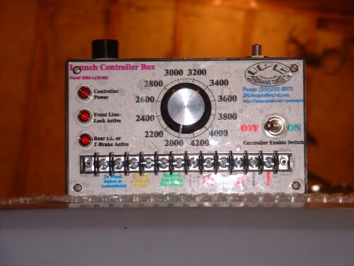

I've heard they are just standard resistors, but have not checked much into it. GIVE ME INFO!!! I've got posts all over the world right now looking for 2 chips, must be searchin the wrong spots. If you know how to do it, PM me with all the dirt, as long as they fit tight and work, hey I'm all for it. We got a guy-eletrical wizard, that started making his own lauch control box that hooks into the MSD ignitions and line locks/tranny brakes, very nice units considering the guy makes them in his home. Here's a pic. He makes these for alot of the locals and recently got laid off from his job-because he makes too much and they're slow, so he came up with this cleaner design and is currently selling them on E-bay. These new units are alot nicer than the first ones he made, they work the same, these just look more professional IMO. He had boxes special made for packaging, includes all instructions, wiring, everything. Kinda weird knowing him personally cause he'll probably get rich when he starts trying to market to the speed catalogs by doing something he enjoys.
