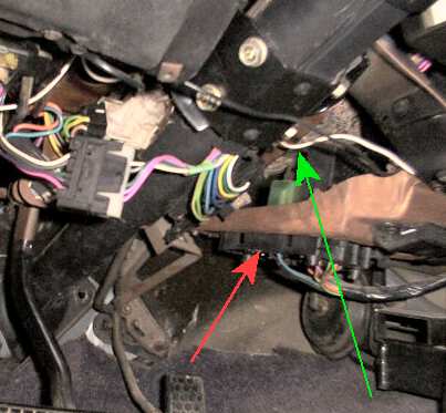

Start with turning on the hazzards and walking around the car looking for burnt out signal bulbs (the hazzards will flash regardless unlike the flasher relay). If you can verify the bulbs (including the front sidemarkers) all flash and are good, replace the relay located in the dumbest _________ (use your own descriptive) place it could be (on certain cars).
The place I've seen it commonly is above the "convenience center" (red arrow), which pulls down, and is held by a crappy clip to the dash/steering column brace just above (green arrow). The relay simpy unplugs to replce, just getting to it though it the b---h.
