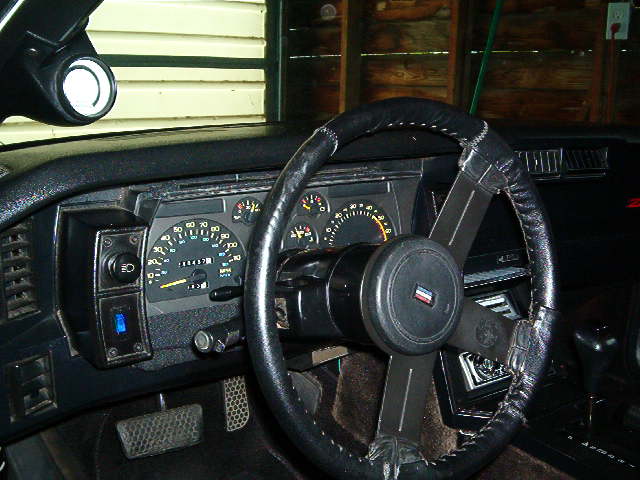

Well Got it all done and it only took me about 4 hours everything works GREAT! I used a buffer box from a 87 olds delta88 and it works GREAT I love it!

Here are some picks of it I think it looks really nice! :lala:
