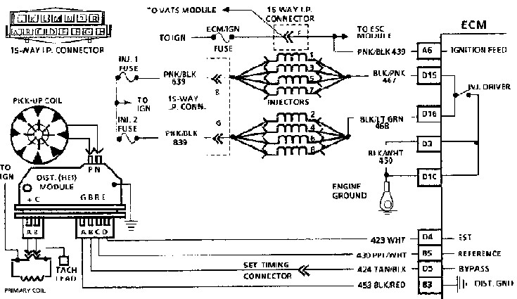

i was using a noid light from snap on. Not some **** tool from my box And yes its only when the car won't start. When it starts the light is very bright and pulces good.
I think the problem lies somewhere between the ecm and the wiring harness for the injectors. Does anyone know what runs the power from the ecm to the harness for the injectors. Tried replacing the ecm and did nothing to help. Thats why i think its the wiring.

injector schematic
Something like this maybe?

Your engine is wired with two separate banks of four injectors. The only wiring common to all 8 injectors is the ignition switch and the ECM ground connection (labeled ENGINE GROUND on the schematic).

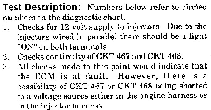

The following goes with the schematic in my last post. Hope you can read it.

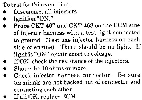

pt 2
