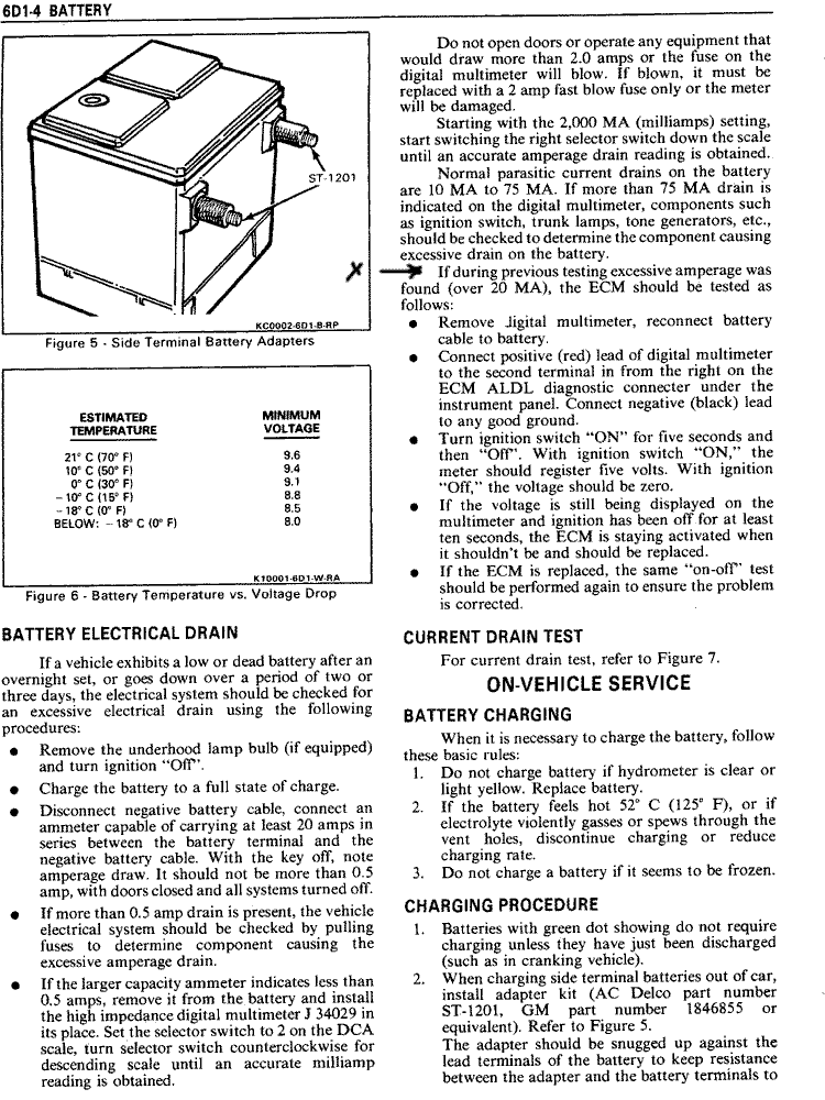

Check this battery drain info and see if it will help with your problem.

Based on Tricksters attachment, it looks like up to a 0.5 amp drain is normal??
phil
10 MA to 75 MA= .010 amps to .075 amps
