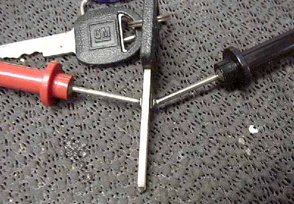

What has happened is that you just bought the new VATS lock cylinder and the brass key that came with it. You have to buy the key with the pellet separately and have the coded key cut from the brass key. If you have the old key, take it to the local dealership and have them cut you a coded key with the same resistance value as your old key. Here is how you find the resistance value of a key with the pellet. With a multimeter set to OHM's apply the probes to the side of the key as shown.
