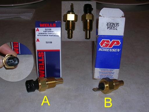

I'm bringing this back after a few months because I dropped this project in favor of other stuff. My gauge is still not working. I followed the green wire as far as I could and it looks good. So I'm thinking my sensor is internally shorted like you said. The wire I followed has a slip on connector and is located below the driver side exhaust manifold. Is that the right one. I want to replace is but I want to make sure I get the right one. Is is one of the ones pictured below?
Thanks.

I'd say B is the temp sensor that goes into the block. Check this thread for a reference.
A looks like the one that goes into the intake.
https://www.thirdgen.org/techbb2/sho...hreadid=245645
It may help.

Yea, those are my two sensors and the answers i found out, were that (A) was the one that sends to the ECM and is to go in the intake by the thermo. (B) is the one that sends to the temp guage and goes in the driver side head.
B only has a single connection becasue its grounded to the head by the threads

Thanks for the info. That was my guess. BTW, when I unscrew this, will coolant leak out? Will I need to teflon tape the threads when I reinstall it? If so, will it not affect the ground issue mentioned above?

Yes coolant will leak out, actually pour out is more like it.
Yes you need to teflon tape the threads.
It should have no effect on the ground issue.

Make sure they aren't selling you a switch instead of a sender. Advance and Autozone both gave me the switch, and couldn't find the sensor in their stores.
If you want to check your sender here is the resistance chart.
GM Temperature Sensor Resistance
Degrees F Degrees C Ohms
20º -7 13,500
40º 4 7,500
70º 21 3,400
100º 38 1,800
160º 71 450
210º 99 185
