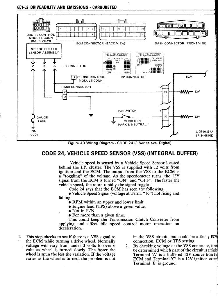

Here is a trouble shooting chart for your code 24 that might help.

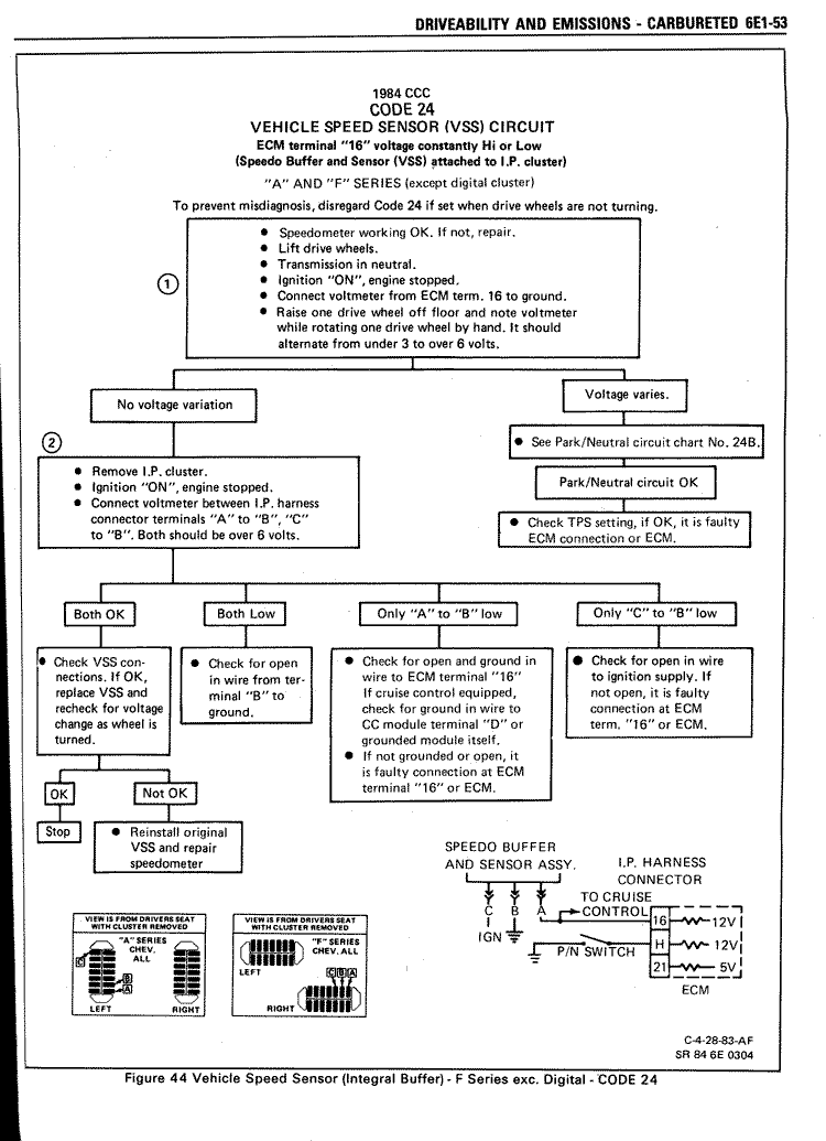

page 2

T, I think he damaged the wires out of the speedo head perhaps when replacing the cable. There are 2 very fine wires coming out the back of the speedo as I recall. It's a classic symptom of no VSS signal from the speedo especially since it happened right after the cable broke. The hall generator is in the speedo head then goes to the buffer for amplification and pulse shaping. Double check the back of the speedo, I'll wager thats where it is. And, that symptom(SES) will not occurr until after about 10 min of driving.
I think that is what happened also, this gives him an idea of where to start looking.
