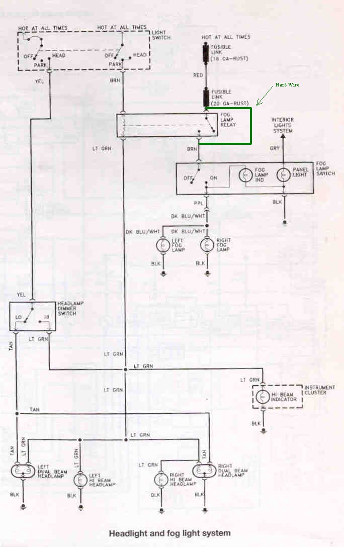

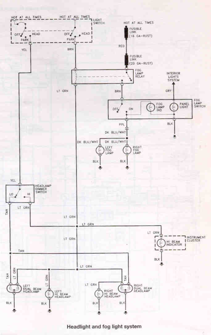

I searched and found this diagram... but I'm not very good at electronics so can't really read it that well. Is this the stock setup (check pic)? Is it possible to "fix" it in the enginebay area so they work seperately? Or do I have to take the interior apart to get to the switch?

Maybe Im missing something here, but the way my fog lights are rigged, you have to turn on the Parking lights, and then you can run the fog lights. I am not the original owner, so maybe they wired it differently that stock? But is this not exceptable?? I never used my headlights when I lived in Ontario, I always just ran my fog lights. When I moved to Alberta, the Cops had an issue with me not using my headlights so I had to stop.

Anyways, I believe this is how you will need to wire it. If I am incorrect, someone will point this out. You are basically going around the relay switch from the Parking switch. To do this right, you will want to get in where the switch is behind the dash. Its not too much work, Ive had my dash apart a few times.
Dont take a wire straight from the battery, because when you shut the car off and the lights are on they beep at you to let you know, but if the power is straight from the battery and you dont realize you left them on, you will come back to a dead battery.
