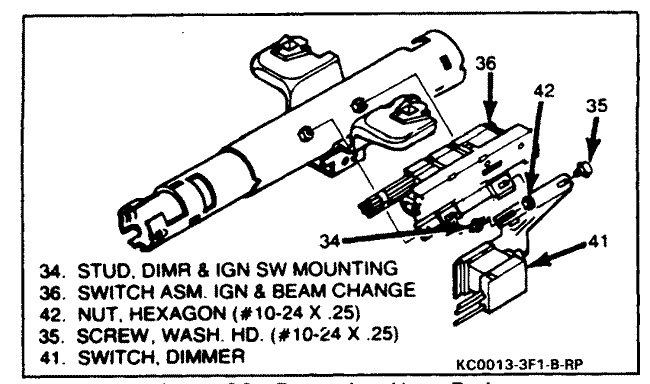

Maybe this will help you out some or at least point you in the right direction.

page 2

page 3

page 4

Thanks for the help guys...the rod had slipped out of the recepticle in the dimmer switch. All fixed. Now all I gotta do is firebomb Autozone for suggesting the most expensive/complicated fix for my turning signal when it just needed a $2/10 min fix.
