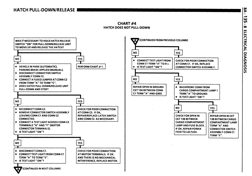

Originally posted by 91 z28 350
Just checked again and its fine. Any guess why its still not working ?
Here is a nice troubleshooting chart for you to look over, if you need a schematic for it I just posted one in this thread. The schematic you want will be the last two pictures.
https://www.thirdgen.org/techbb2/sho...hreadid=273634
