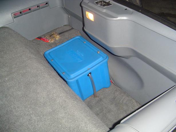

here is mine i have to get a new box though plastic piece of crap.

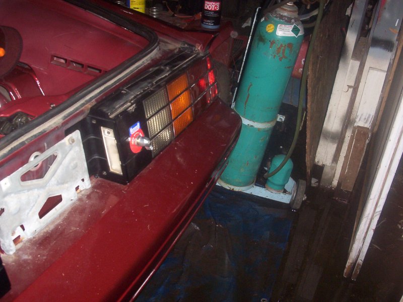

here is the cut off switch.

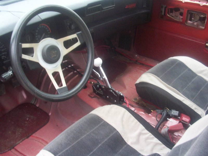

i ran my postive wire on the inside of the car along the passenger side and i routed the kill wire right with it.
1.

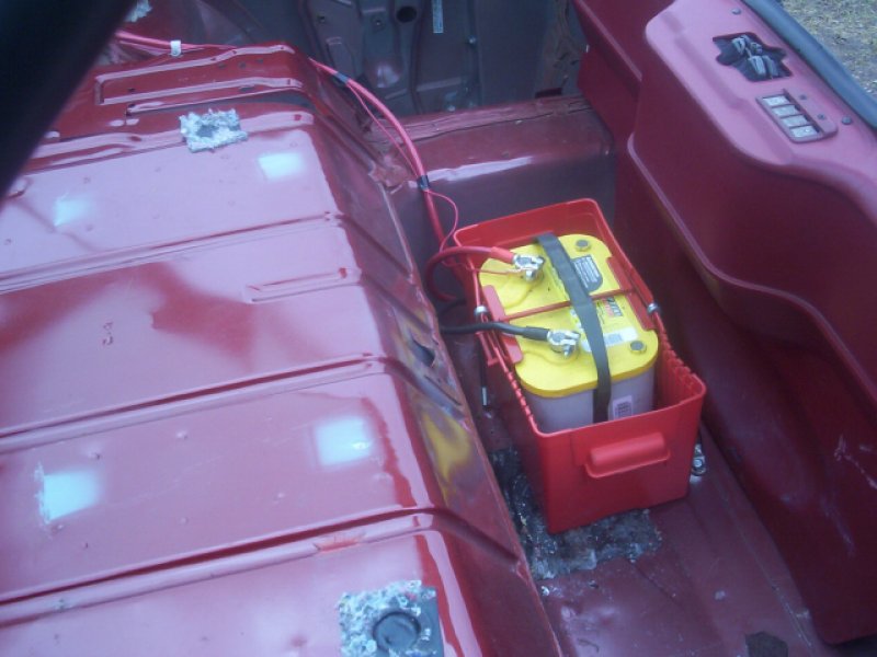

2.

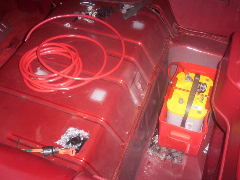

last one
