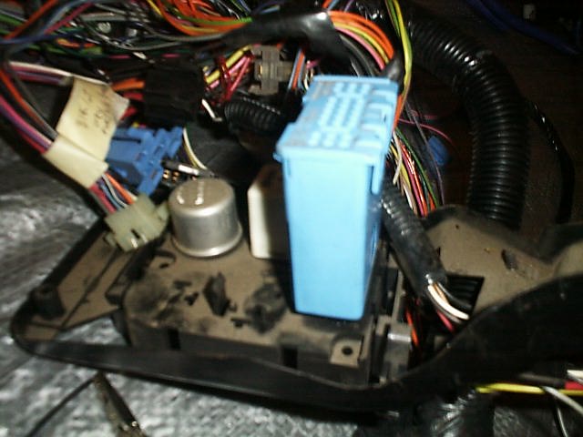

HERE IT IS!!!!!!!!! or at least i think its this.
Here is the picture of the part under the dash where you plun a code scanner in. If you were to remove that piece from the car, you would see these parts including the Big Blue Box. What in the heck is this blue box for? Dosent it have the door buzzer in it???
Here is a pictire of the underside. These are the wires that go into the Big Blue Box.
Most of the wires there have continuity (readings anywhere from 20% to 100%) between them when that Blue Box is plugged in. These wires all spider out into many parts of the car including the ecm.
When I unplug the box there is NO continuity between the wires.
Correct me if I am wrong but I dont think that blue box should cause the pink wire make a connection to the black wire and to the grey wire and to the orange wire, to the green wire, and to the black white wire. All those connections are cut off when I pull the blue box out.
Could you or somebody PLEASEEEEEEEE take their cover off and test the wires in this picture to see what happens on a normal running car??

That entire panel is called the "Convenience Center (yeah, really convenient to get to, eh?). It contains the flasher, warning chime, and IP lamp dimmer control on Pontiacs. That "blue dealy" is the warning chime and associated logic.
Either that, or it's the warp field generator/reactor control module - I can't remember clearly.
