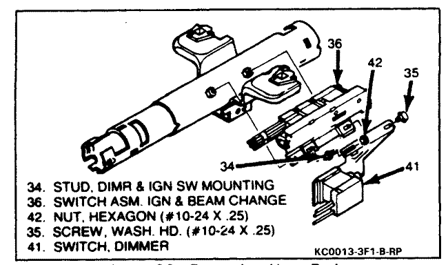

You need to adjust the dimmer switch on the steering column above the ignition switch. See enclosed pictures.

Thanks a lot. I was told something to the effect of that but not as in depth. thanks a lot for the help.

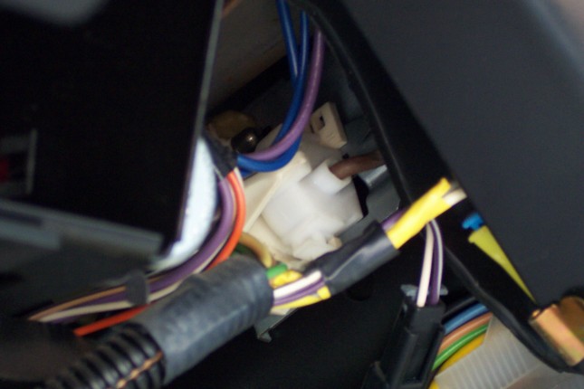

I took off lower trim piece under the steering wheel and found the switch. The piece that i found didnt look like the one on the picture though. Is this the piece i would adjust or am i looking at the wrong one? It moves when i pull on the lever so its part of the high beam switch but i cant find where you adjust it.
