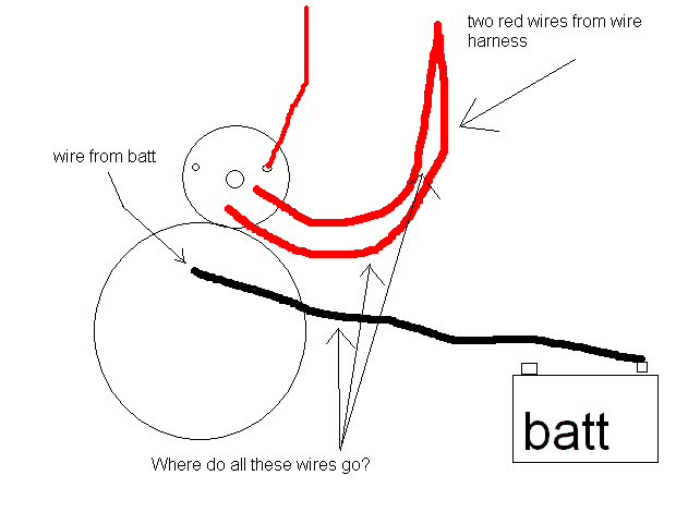

like this? i recall there being more wires involved

Ok dude today i messed with the car a bit. the way i had it set up was the little red wire on the far right small terminal, the black wire from the battery and the two red wires that come from the wire harness where all on the middle big nut on the starter. this can't be right.
Heres a pic of what i have going on where do these wires hook up to? oh and by the way i did totally fry the one black wire that goes to the battery and i will be fixing that...

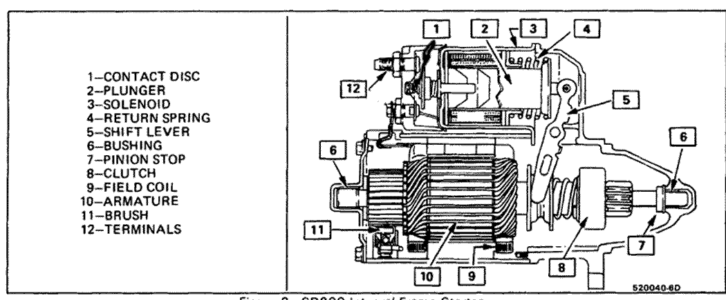

Here is a picture of where you are supposed to put your wires. From the drawing you supplied you have the wire from the battery going to the bolt for the support bracket on the front of the starter. All wires with the large terminal lugs and this includes the big wire from the battery go on the post in this picture that is labeled #12. The wire with the small terminal lug goes on the small post that is marked #1 in this picture. It is the small post closest to the engine block.
