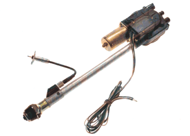

The full part number is 88891017. The price shipped fom www.gmpartsdirect.com is about $120. An example picture is below.
The cable within the mast of your antenna probably broke. I am in-process of a similar repair. I plan on replacing just the cable. I believe the $20 kit you mentioned is the 22038195 cable kit.
