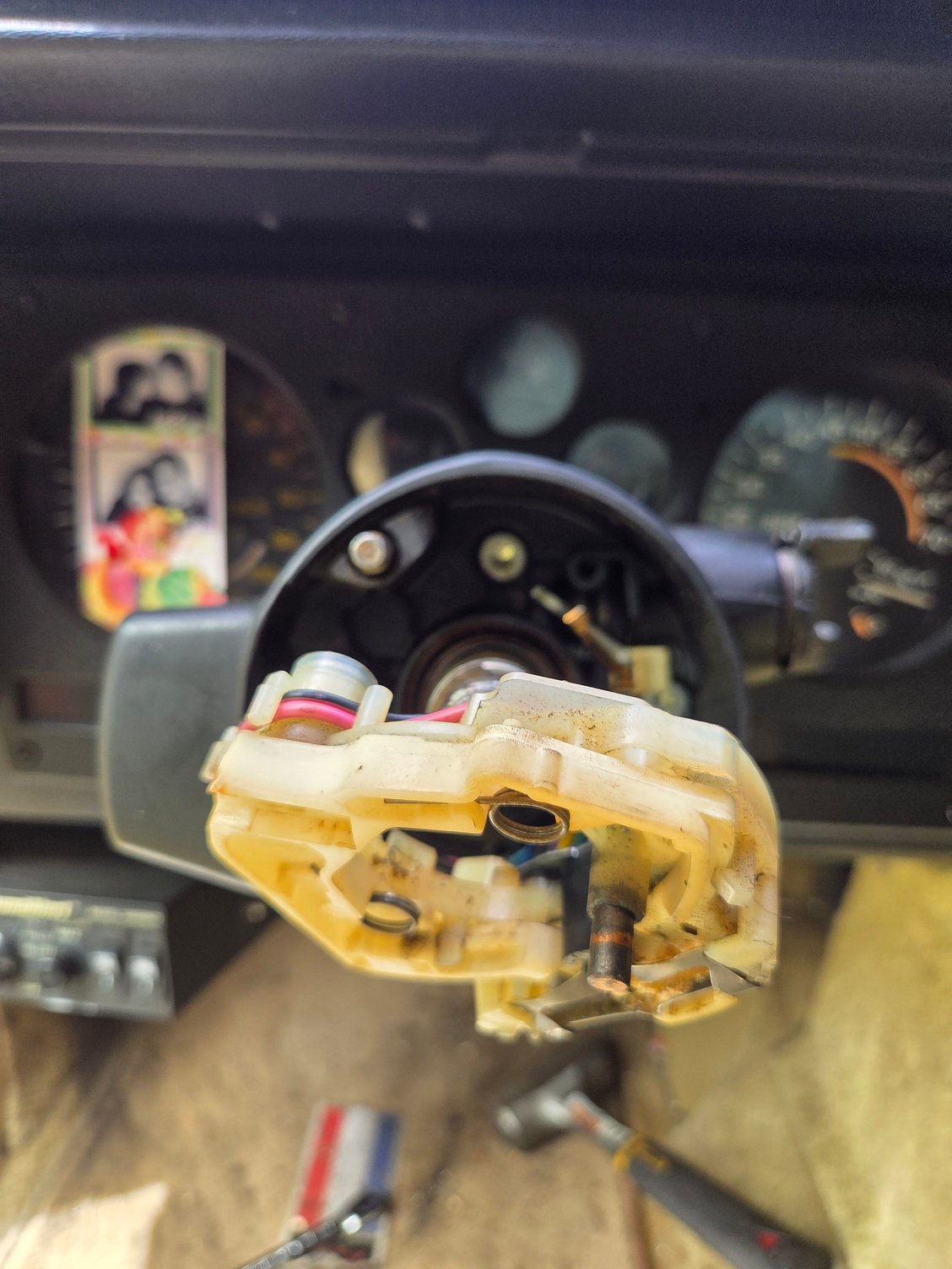

Hello everyone. This is my fir
st post here lol. I have a 82 camaro that loves eating wiper stalks. Im on my third and it broke inside the wiper switch. Im locking into replacing the wiper switch completely as im doing a new turn signal switch aswell. Does anyone know where I can get a new wiper switch?
Old May 22, 2026 | 03:36 PM
Posts: 28,012
Likes: 2,491
Re: replacing wiper switch??????'s
Not sure about the wiper switch, I'd try rockauto to start I suppose; butt if it breaks the stalk, in addition to the stalk itself, it probably needs the turn signal switch too.
