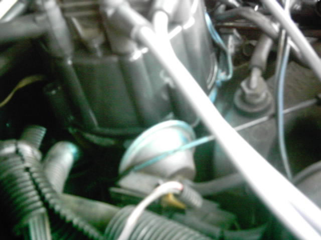

Heres a pic of it..so this will work with my non cc carb...what vacuum advance hole should i plug it in

That's a non-CCC distributor as evidenced by the silver vacuum advance can. Plug it into a source of ported or non-ported vacuum, depending on what you and your engine prefer.

do u no what port is the best i have it in the only port on the back

Usually with a stockish cam it'd be connected to a ported vacuum source on the front of the carb. A ported vacuum source will have no vacuum at idle, but will see vacuum as soon as the throttle blades are opened.
