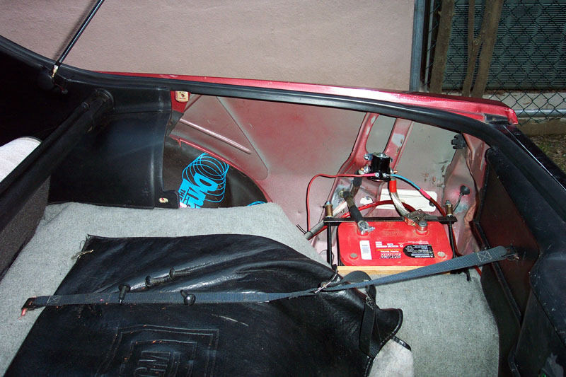

I used the BMR tray and wired it up exactly as recommended by MAD Electrical, who is quoted in every car mag out there. I have attached pics of the install. The 1/0 cable is very heavy and expensive.
I used approxiamtely:
15 feet of 1/0 red (connect remote starter solenoid to original solenoid)
2 feet of 1/0 silver (1 foot from battery to ground, 1 foot from engine to body)
10 feet of 10 guage (to connect ignition start wire to remote solenoid)
5 1/0 copper lugs
2 power distribution junctions (one under hood, one under dash)
2 battery terminals
20 feet of 8 guage (rewire alternator and under dash power supplies as per Mad electrical)
1 12 gauge fusible link
lots of 8 gauge ring terminals
Can't remember off hand anything else
. I had left over of everything, but not much
Attached Thumbnails Battery relocation questions...-passenger-hatch-area-panel   Battery relocation questions...-battery-relocated.jpg   Battery relocation questions...-passenger-rear-hatch-area.jpg

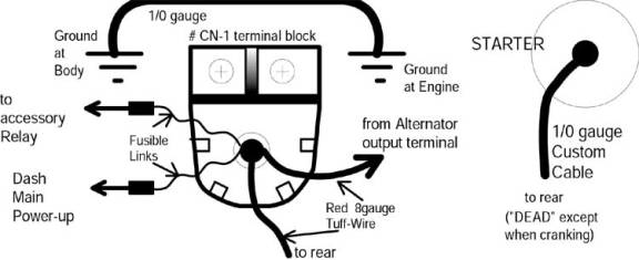

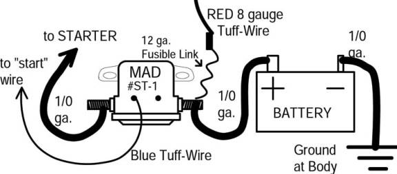

wiring diagrams
All wires route inside the car behind the sail panels, under the carpet trim along the door, under the kick panel. I drilled a hole in the firewall, used a thick rubber grommet, ran out to the engine compartment to the starter.
The 1/0 starter cable is only "live" during cranking almost eliminating any chance of a short causing a fire.
The first diagram is the "trunk" area.
The second diagram is under hood area.
Attached Thumbnails Battery relocation questions...-trunk-area.jpg   Battery relocation questions...-engine-area.jpg

Thanks for the posts Nightcruzer. I had gone ahead and installed mine a couple months back, but never posted pics. I went with an optima red top battery and a battery tray I found on E-Bay. I'll try and get you some pics later this week. -Josh
