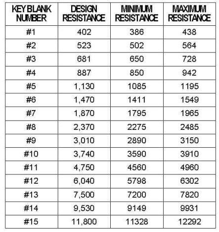

It doesn't matter which side you cut the wires on. Mine is cut on the car side. I figured it would prevent that connector from introducing any extra resistance, resulting in a mis-read resistor.
Keep in mind, every time the VATS module sees the wrong resistance, it will instruct the ECM to "lock out" any attempts to start for the next 3 minutes. I always waited 5 between tries.
This may help you out too:
Image is also attached if you want to keep it handy. I recommend writing down the resistance that you find that works, in case you ever need to replace that resistor.
Hope this helps.

Hi thankyou very much for the chart does this chart apply to 1991 also or all of these type keys with chip

Re: VATS Problem?
should apply to all the 3rd gen f bodies with vats.

I don't know if you can get the key resistance from the vin code or not. I would think it would not be possible, since a potential thief could walk up to the car, get the vin and match it to the correct resistance, enter the car, wire in the resistor, bust the lock cylinder, and be gone. Would just make it too easy...
I found mine by going down the list trying each value and waiting 5 minutes in between.

There is nothing on the car that will show you what the car is looking for. I just got done bypassing mine the night before last because the damn thing left me in the parking lot after work with the Security light smiling at me for 30 minutes before i could get it started. What you will need to do if you can't measure off a key is just make up 15 different resistor combinations from radio shack and try till you find one that lets it start.
This is basically the same way a shop does it exept they have a fancy box that has all the resistors build into it. Try one, wait 5 min, try another wait 5..etc. Since I had my key I just measured it and soldered up a resistor into the plug below the dash where I could un-plug it if i really didnt want someone driving the car
Don't stress about getting the exact resistance value listed either, just somewhere close to the middle as possible. Mine should have been the 1130 but the key measured 1123. Put together a 1K and a 150 resistor and measured out exactly to 1123 at room temp (how bout that). Then I super heated them to check resistance at the point where the solder was melting..still within range. Then I took a can of that compressed air and turned it upside down so it would blow out the freezing liquid, still within range. Then I made a new one that wasn't burnt/frozen and works just fine. Run some shrink tubing up each side of it till they meet (was soldered in a U shape) then put a bigger one over the whole thing and shrink tube. Then soldered the connectors out of the end of the red cable and shrinked over the leads so they wouldn't short each other out and plugged it in.
