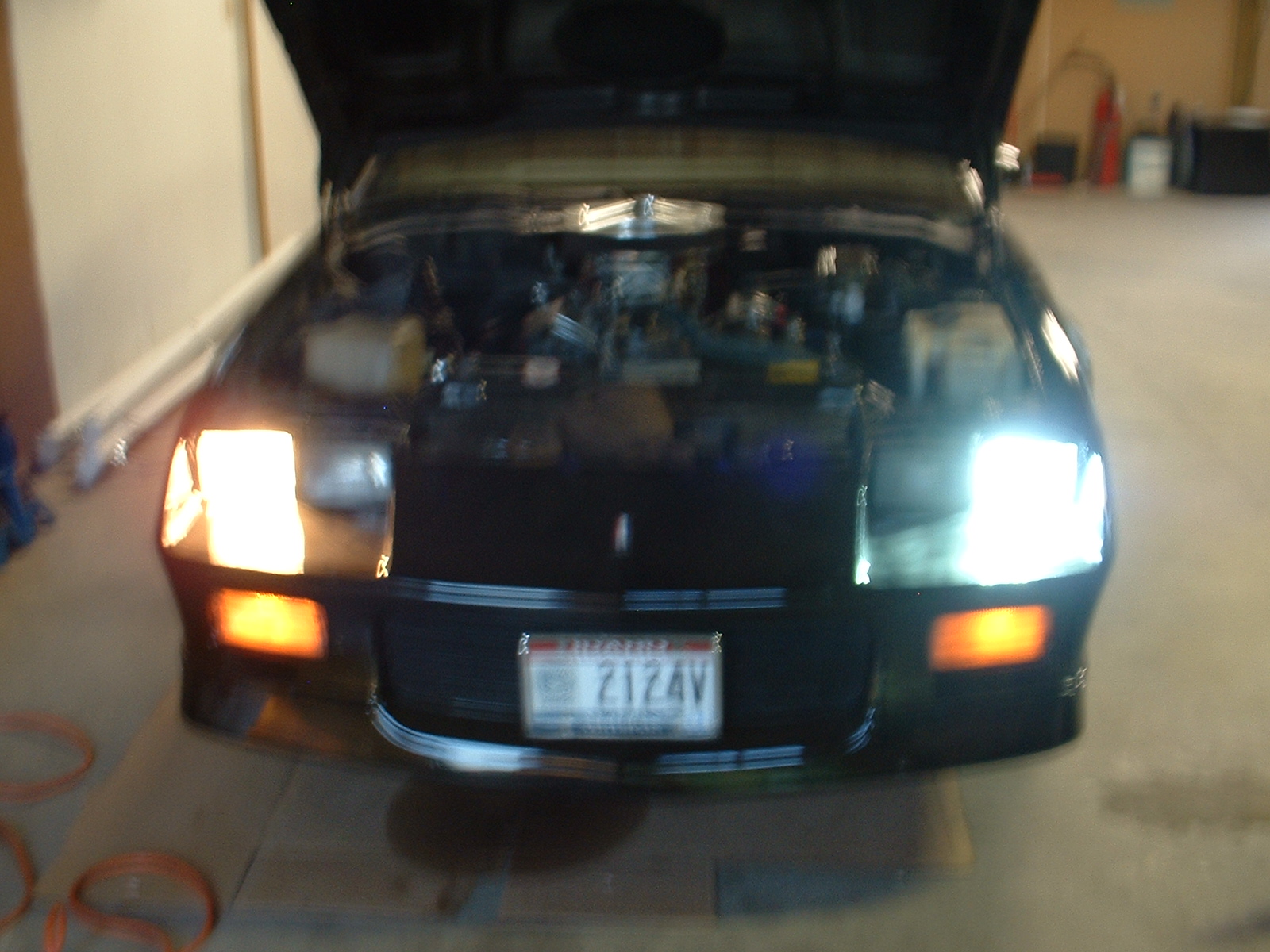

I decided to take some pictures of my HID installation to help those who wanna tackle it. Honestly it was very simple to hook up the wiring. There was no cutting or splicing. Just a plain plug n' play. The install isn't complete yet, I need the projector headlights to finish. I bought my kit at Harbor Freight. I believe the make is Road King.

Like I said this is a very easy installation, and now I'm kicking myself for not doing it earlier.

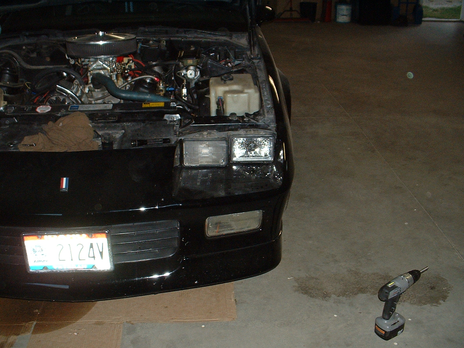

Well I have one projector headlight installed now. Wasn't too bad. No trimming was needed. HID's are frikin amazing! Sorry about the pics, the camera doesn't want to work without the flash.
