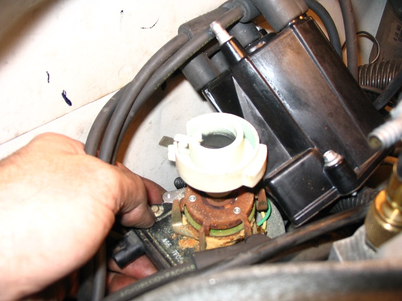

Just a couple of things I would do: Pull the coil wire out of the center of the distributor cap & either use a spark tester or hold the wire 1/4" from a good ground and crank the engine. You are looking for a good healthy spark from the coil wire. I would also replace the ignition module if you haven't already (fairly inexpensive) & check the wires on the pickup coil in the distributor - they usually break and get full of green funk.
In the picture attached (V6 distributor), my finger is on the ignition module & the rusty funky thing under the rotor is the pickup coil. You have to pull the distributor to change the pick up coil but not the ignition module. That should keep you busy for an hour or so!

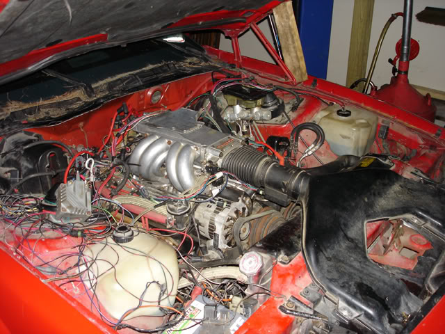

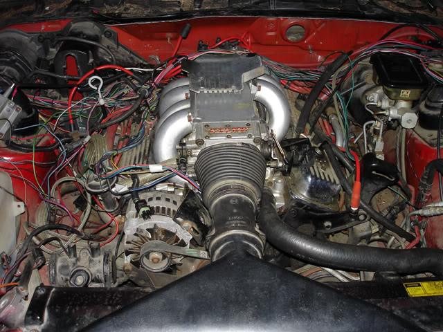

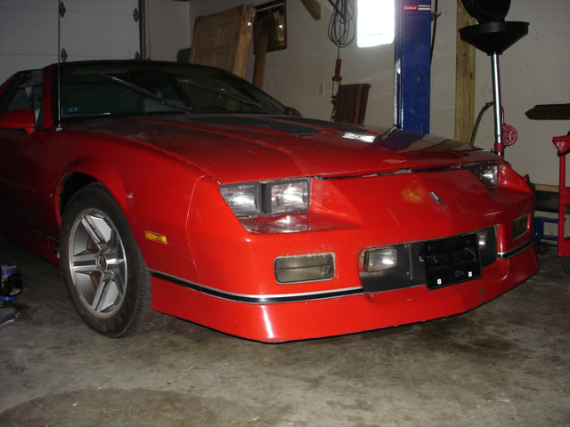

and some eye candies that are crappy pics lol

All of those wires make me wanna laugh and cry @ the same time.....!
I feel for you mang. I hope that you get that car running!!! The exterior looks good from the pics that you posted
