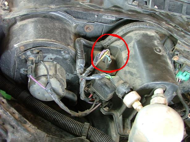

The speed control resistors are under the hood in the heater box. Unplug it and make sure the wires for each speed are giving you full battery voltage. About 14 volts with the car running, 11 with the engine off. If the supplied voltage is o.k. I'd replace the resistor plate. Remove the 2 screws holding the plate down. There will be what appears to be different size springs on the other side of the plate.
The high running slow is odd as it is direct to the fan.

Under the hood on the passenger side of the firewall. See the picture in post #2. There is the flat wire connector going into it. 2 screws holding it in.

they look fine, 4 pins on the top, and springs all coiled the the opposite sides of the posts on the back. it looks untouched and stock.
it is not my realy, i got a replacement one and worked the same way.
i am kinda stuck on this
to remind you, the low and high setting blow low. and the med and med high setting blow high. weird to me...
