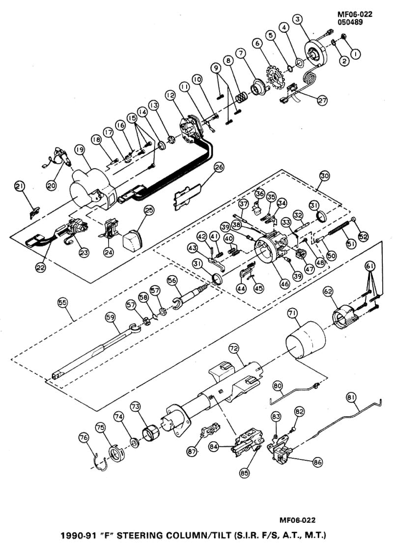

Ok, i ordered one from rockauto. What needs to come apart to install it?
Old Jan 16, 2009 | 05:58 PM
krisb410's Avatar
Joined: Nov 2005
Posts: 2,346
From: Naples, FL
Car: 91 RS Camaro, 75 L82 Corvette
Engine: LO3, 383 Stroker
Transmission: 700R4, TH400
Axle/Gears: 4th gen 3.23 posi/LS1 discs, stock
Re: Issue With Brights
Just the lower dash right above you feet.
Part #86 in the diagram
