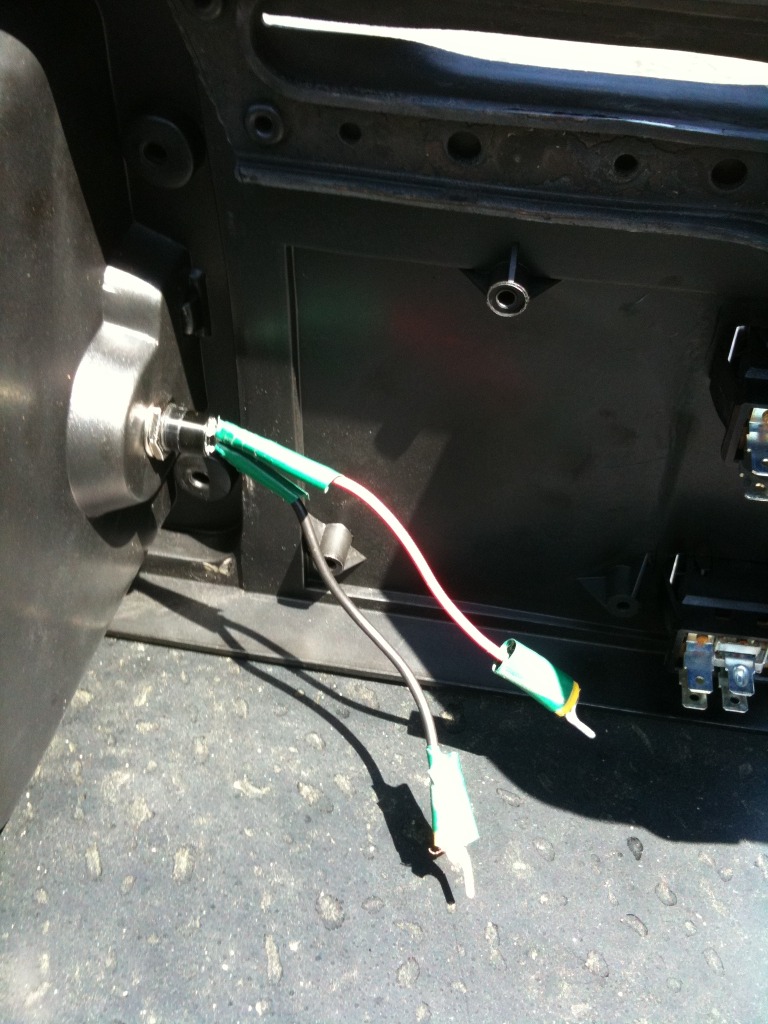

well after a whole day of searching for the relay connector i gave in and just hard wired the switch connector to my switch, here is my results,
i bought a 2 pack of momentary switches from Radio shack($3)
wiring and connectors i already had
the only cutting/massaging i had to do was enlarge the hole under the console lid(you will see in the pic where i am talking about) i had to grind it out just a tiny bit to fit the switch, other than that, no cutting my harness or anything just added an extension from the power wire to the switch and from the switch back to the black wire at the connector, and it works perfect(i even accidentally found out that if you jump the power to the middle wire at the connector you can start your car lol, but i think that has been covered on here) this is what it looks like now

i guess i will just make do with the switch i have wired in now, heres a pic for you all to see my switch wiring(its not pretty because its hot as hell outside but when it gets cooler i will redo it the right way with proper connectors and such, im usually very **** about my wiring)
the black wire plugs into the black wire at the connector, and the Red wire goes to the power wire at the connector, i left the middle connector wire alone and everything works fine

Originally Posted by TraviZ
Hey guys I took this photo of what I found under my center console, maybe I can get some help as to where the circled wires go? I labeled all the colors and the switch that goes to my hatch popping switch on my center console..
the three wires that leave that connector I circled, they do not match any colors at my hatch motor in the back..
so confused what I need to do here to make my switch work again..
Thats in ur 89 iroc? I dont think mine has any of those wires but i can check again when i work on the rs today
Old Apr 11, 2010 | 11:37 AM
TraviZ's Avatar
Posts: 10,494
From: Woodland, CA
Car: '02 Z06
Engine: L33 5.7
Axle/Gears: Stock IRS
Re: Hatch release relay
Yes that is correct, my 89 iroc.
on the left, two wires go to my switch, on the right the three wires go to a relay.
Old Apr 13, 2010 | 12:21 AM
TraviZ's Avatar
Posts: 10,494
From: Woodland, CA
Car: '02 Z06
Engine: L33 5.7
Ok I figured it out myself today..
the orange wire ran all the way to my fuse panel and is constant 12volt.
the black wire runs back to the hatch and pops the hatch..
the yellow wire turns into a green(white stripe) at the connector as poster #1 posted up.. and it also ran to the fuse panel.. I understood the diagram as 12volt as well but that didnt make sense.. so I grounded it, and everything works as intended..
only thing is its not wired through my shifter, so I can pop it at any time, in gear or not..
not a big deal for me as im the only one driving and im not dumb enough to pop it on the highway..
and for anyone that cares, there is a red(with white stripe) at the fuse panel that is also supposed to be 12volt constant and that is power for the hatch pull down motor to do its thing when triggered..
