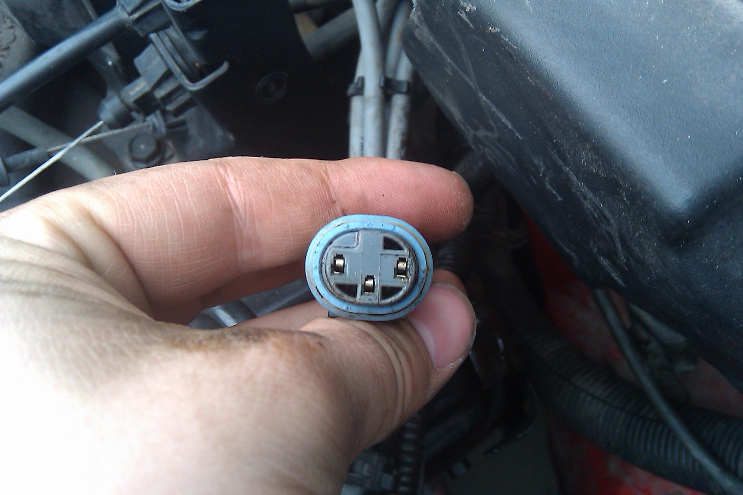

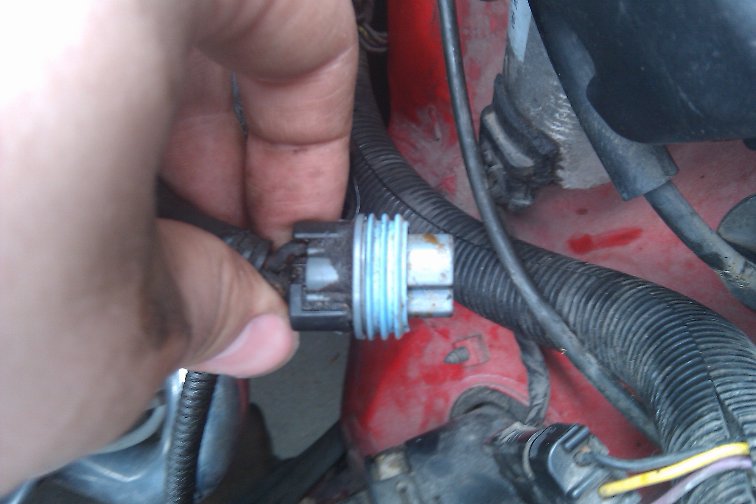

Well I bought a 89 Firebird with no engine, I put my uncles 305 TBI in it because that is what it had originally.
There are 2 wires i cannot for the life of me figure out were they go to and if they are impacting the ability to start.
Power and starter are hooked up fine, I turn the key to crank and the start clicks once, then all power goes out for 2 mins roughly. After the two min period i can try to crank again but get same results.
Even if i hot wire it and put a screw driver across the posts on the starter same thing, one almost mechanical click, then no power to anywhere for 2 mins.
Attached Thumbnails New engine and wont start-imag0001.jpg   New engine and wont start-imag0010.jpg   New engine and wont start-imag0011.jpg

Re: New engine and wont start
Originally Posted by kwheinrichs
There are 2 wires i cannot for the life of me figure out were they go to and if they are impacting the ability to start. .
Not familar with TBI but if it was a TPI I would say that is the connector for the combination oil pressure switch/sender unit at back of the block behind dist;
Does OP gauge and runs fuel pump when oil pressure over 4 psi
The oil pressure switch your talking about is located right above the oil filter on TBI cars, but it looks exactly like the one in your pic vetteoz.
That indeed looks like the oil pressure sender connector, but it would have no effect what so ever on the starter. It sounds like either the starter is bad, or maybe a bad/loose electrical connection. The other wire thats disconnected in the 3rd pic (yellow and black wires) looks to go to the temp gauge sender on the front of the manifold.
