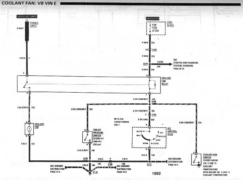

Stock uses 20A to control the fan relays and alt. I dont see any reason to deviate. Relays take almost nothing to kick on
Pretty much the only thing you're changing from the stock relay circuit is the ground leg. Instead of thermal switch/ECM engage fcn, you're using the "Fan controller" which is a fancy product dressing up a simple potentiometer
http://www.austinthirdgen.org/mkport...an_V8_vinE.jpg

I would wire up the fan the way the schematics show to do it that Camaronewbie has provided

In the schematic provided by Camaronewbie you do away with the relay one less item to break down you could still have the light if you look at the schematic, light will stay on as long as fan is running if fan stops breaking the current flow to ground... light will go out!Plus you have a manual by pass as well such as one you have shown but without the relay.

Re: Help with fan controller
Originally Posted by irock88
in regards to your voltage drop the factory fan is already powered from the fuse box so where does the voltage drop come from
You know that do you?
Refer post #18 above
I put a picture up so you can " understand " it better!
Originally Posted by vetteoz
You obviously need to brush up on how your car is wired
Have a look at a factory wiring diagram.
Your '88 5.0 TPI fan wiring shown
Fan power comes direct from battery through fusible link; only the relay control side is from fuse block.
As I said above ;more direct path to fan - less voltage drop
follow the fusible link in the car where does it go to (relay drivers side firewall )then from that relay where does it go and you want to talk about voltage drop on the current it draws
