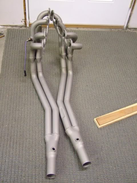

More concerned with the O2 not reading correctly.
My car has long tube headers
Ignore the O2 with the purple wire. That is the one I have been using
With a multiport system, totally non stock.
I just want to make sure the O2 I am not using will function when I need it if I use the 3 wire system
On another Triumph I am building with TBI. Is there a problem if you run 3 wire O2's too close to the manifold?

in the picture it looks like the o2 sensor is in one of the primary tubes? wouldn't that hurt some of the flow through that exhaust port?
a 3 wire will work fine down further.. you can screw both in and heat both of them I don't see why that wouldn't work.. they will both wear out eventually connected to the computer or not.
Old May 27, 2011 | 05:50 PM
DNK's Avatar
DNK
Joined: Feb 2008
Posts: 18
From: Seattle
Car: 80 TR7 V8 w/ 91 Z28 OBD1
Engine: 3.5 Liter
Axle/Gears: 3.45
Re: heated O2 sensor?
Are you talking about the one at the top or the ones downstream at the end?

sorry.. the one at the top.

That's why I plan on changing to the ones on the bottom.
I wish there was a way for the OBD 1 ecm to read both O2's
